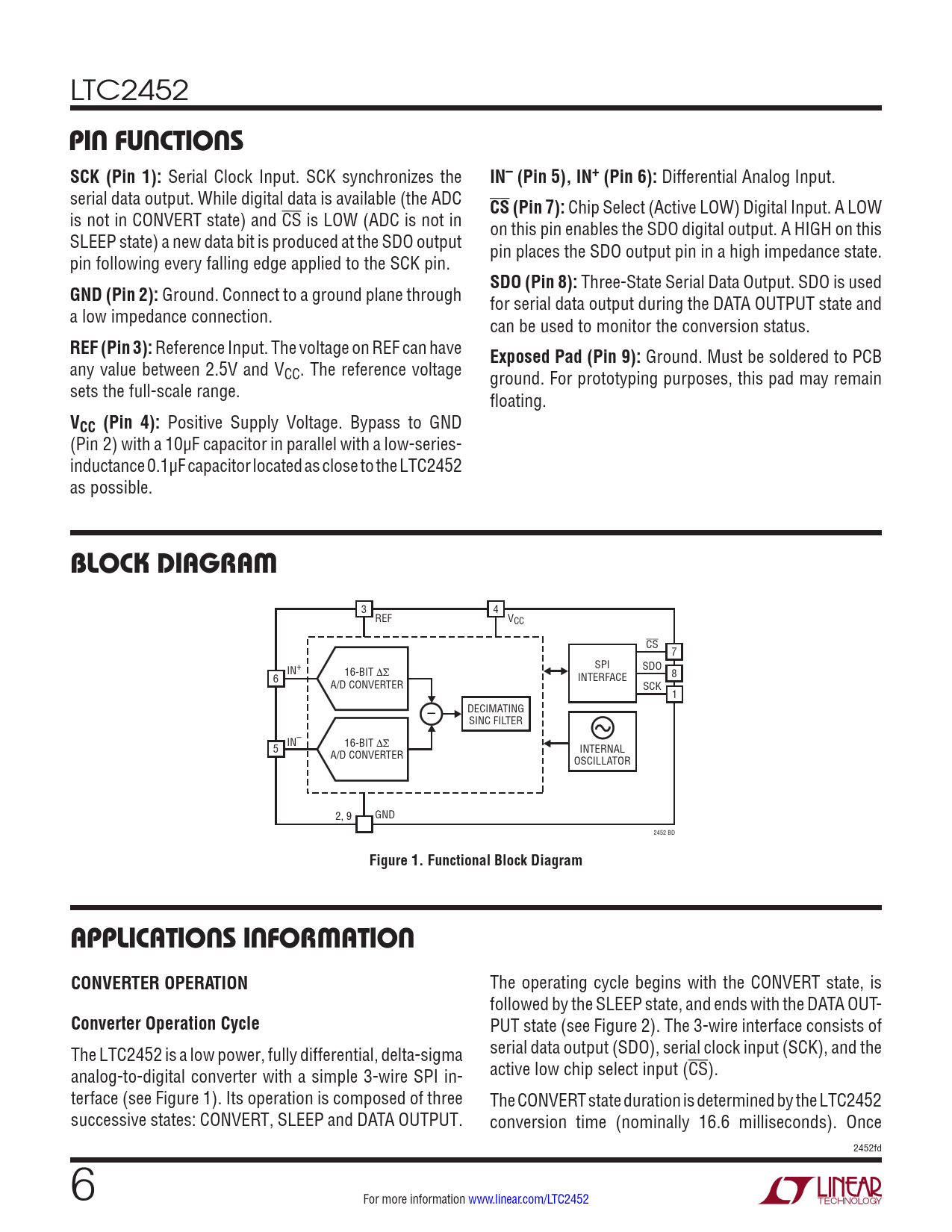

pin FuncTions. SCK (Pin 1):. IN– (Pin 5), IN+ (Pin 6):. CS (Pin 7):. SDO (Pin 8):. GND (Pin 2):. REF (Pin 3):. Exposed Pad (Pin 9):
pin FuncTions SCK (Pin 1): IN– (Pin 5), IN+ (Pin 6): CS (Pin 7): SDO (Pin 8): GND (Pin 2): REF (Pin 3): Exposed Pad (Pin 9):
LTC2452
Serial Clock Input. SCK synchronizes the
Differential Analog Input. serial data output. While digital data is available (the ADC
CS (Pin 7):
Chip Select (Active LOW) Digital Input. A LOW is not in CONVERT state) and CS is LOW (ADC is not in on this pin enables the SDO digital output. A HIGH on this SLEEP state) a new data bit is produced at the SDO output pin places the SDO output pin in a high impedance state. pin following every falling edge applied to the SCK pin.
SDO (Pin 8):
Three-State Serial Data Output. SDO is used
GND (Pin 2):
Ground. Connect to a ground plane through for serial data output during the DATA OUTPUT state and a low impedance connection. can be used to monitor the conversion status.
REF (Pin 3):
Reference Input. The voltage on REF can have
Ground. Must be soldered to PCB any value between 2.5V and VCC. The reference voltage ground. For prototyping purposes, this pad may remain sets the full-scale range. floating.
VCC (Pin 4):
Positive Supply Voltage. Bypass to GND (Pin 2) with a 10µF capacitor in parallel with a low-series- inductance 0.1µF capacitor located as close to the LTC2452 as possible.
block DiagraM
3 4 REF VCC CS 7 IN+ SPI 16-BIT SDO ΔΣ 6 INTERFACE 8 A/D CONVERTER SCK 1 DECIMATING – SINC FILTER IN– 16-BIT ΔΣ 5 A/D CONVERTER INTERNAL OSCILLATOR 2, 9 GND 2452 BD
Figure 1. Functional Block Diagram applicaTions inForMaTion CONVERTER OPERATION
