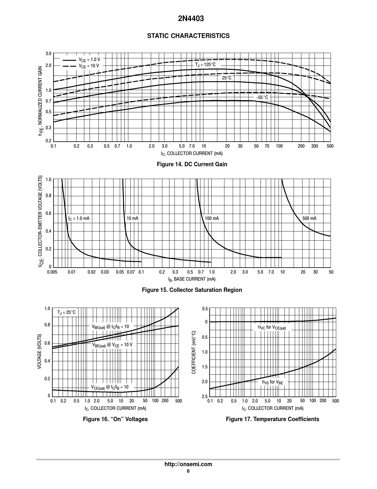

2N4403. STATIC CHARACTERISTICS. Figure 14. DC Current Gain. Figure 15. Collector Saturation Region. Figure 16. “On” Voltages
2N4403 STATIC CHARACTERISTICS Figure 14 DC Current Gain Figure 15 Collector Saturation Region Figure 16 “On” Voltages
3.0 VCE = 1.0 V 2.0 T V J = 125°C CE = 10 V 25°C 1.0 −55°C 0.7 0.5 0.3 FEh , NORMALIZED CURRENT GAIN 0.20.1 0.2 0.3 0.5 0.7 1.0 2.0 3.0 5.0 7.0 10 20 30 50 70 100 200 300 500 IC, COLLECTOR CURRENT (mA)
TS) 1.0 (VOL 0.8 TAGE 0.6 IC = 1.0 mA 10 mA 100 mA 500 mA 0.4 0.2 CEV , COLLECTOR−EMITTER VOL 0 0.005 0.01 0.02 0.03 0.05 0.07 0.1 0.2 0.3 0.5 0.7 1.0 2.0 3.0 5.0 7.0 10 20 30 50 IB, BASE CURRENT (mA)
1.0 0.5 TJ = 25°C 0 0.8 VBE(sat) @ IC/IB = 10 qVC for VCE(sat) C)° TS) 0.5 0.6 VBE(sat) @ VCE = 10 V 1.0 TAGE (VOL 0.4 VOL 1.5 COEFFICIENT (mV/ 0.2 2.0 qVS for VBE VCE(sat) @ IC/IB = 10 0 2.5 0.1 0.2 0.5 1.0 2.0 5.0 10 20 50 100 200 500 0.1 0.2 0.5 1.0 2.0 5.0 10 20 50 100 200 500 IC, COLLECTOR CURRENT (mA) IC, COLLECTOR CURRENT (mA)
Figure 16. “On” Voltages Figure 17. Temperature Coefficients http://onsemi.com 6
