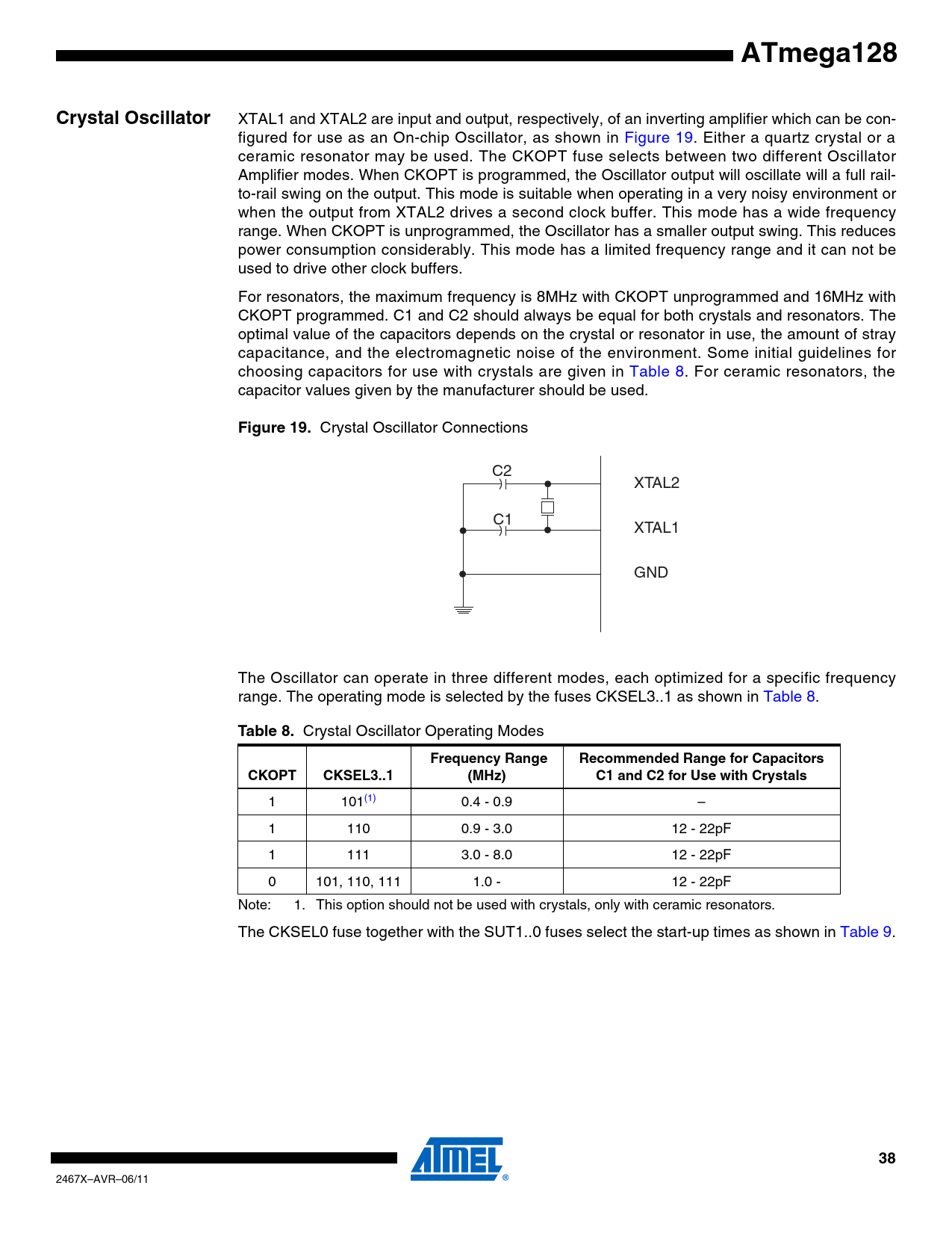

ATmega128 Crystal Oscillator
XTAL1 and XTAL2 are input and output, respectively, of an inverting amplifier which can be con- figured for use as an On-chip Oscillator, as shown in Figure 19. Either a quartz crystal or a ceramic resonator may be used. The CKOPT fuse selects between two different Oscillator Amplifier modes. When CKOPT is programmed, the Oscillator output will oscillate will a full rail- to-rail swing on the output. This mode is suitable when operating in a very noisy environment or when the output from XTAL2 drives a second clock buffer. This mode has a wide frequency range. When CKOPT is unprogrammed, the Oscillator has a smaller output swing. This reduces power consumption considerably. This mode has a limited frequency range and it can not be used to drive other clock buffers. For resonators, the maximum frequency is 8MHz with CKOPT unprogrammed and 16MHz with CKOPT programmed. C1 and C2 should always be equal for both crystals and resonators. The optimal value of the capacitors depends on the crystal or resonator in use, the amount of stray capacitance, and the electromagnetic noise of the environment. Some initial guidelines for choosing capacitors for use with crystals are given in Table 8. For ceramic resonators, the capacitor values given by the manufacturer should be used.
Figure 19.
Crystal Oscillator Connections C2 XTAL2 C1 XTAL1 GND The Oscillator can operate in three different modes, each optimized for a specific frequency range. The operating mode is selected by the fuses CKSEL3..1 as shown in Table 8.
Table 8.
Crystal Oscillator Operating Modes
Frequency Range Recommended Range for Capacitors CKOPT CKSEL3..1 (MHz) C1 and C2 for Use with Crystals
1 101(1) 0.4 - 0.9 – 1 110 0.9 - 3.0 12 - 22pF 1 111 3.0 - 8.0 12 - 22pF 0 101, 110, 111 1.0 - 12 - 22pF Note: 1. This option should not be used with crystals, only with ceramic resonators. The CKSEL0 fuse together with the SUT1..0 fuses select the start-up times as shown in Table 9.
