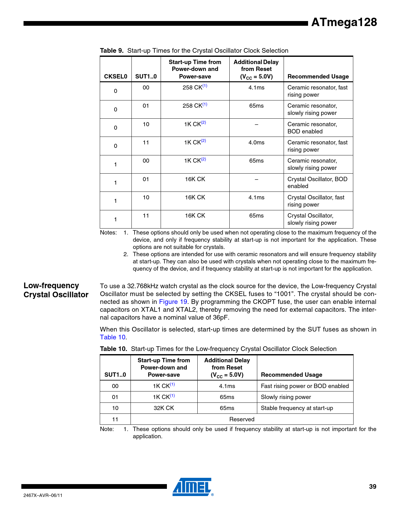

ATmega128 Table 9.
Start-up Times for the Crystal Oscillator Clock Selection
Start-up Time from Additional Delay Power-down and from Reset CKSEL0 SUT1..0 Power-save (VCC = 5.0V) Recommended Usage
00 258 CK(1) 4.1ms Ceramic resonator, fast 0 rising power 01 258 CK(1) 65ms Ceramic resonator, 0 slowly rising power 10 1K CK(2) – Ceramic resonator, 0 BOD enabled 11 1K CK(2) 4.0ms Ceramic resonator, fast 0 rising power 00 1K CK(2) 65ms Ceramic resonator, 1 slowly rising power 01 16K CK – Crystal Oscillator, BOD 1 enabled 10 16K CK 4.1ms Crystal Oscillator, fast 1 rising power 11 16K CK 65ms Crystal Oscillator, 1 slowly rising power Notes: 1. These options should only be used when not operating close to the maximum frequency of the device, and only if frequency stability at start-up is not important for the application. These options are not suitable for crystals. 2. These options are intended for use with ceramic resonators and will ensure frequency stability at start-up. They can also be used with crystals when not operating close to the maximum fre- quency of the device, and if frequency stability at start-up is not important for the application.
Low-frequency
To use a 32.768kHz watch crystal as the clock source for the device, the Low-frequency Crystal
Crystal Oscillator
Oscillator must be selected by setting the CKSEL fuses to “1001”. The crystal should be con- nected as shown in Figure 19. By programming the CKOPT fuse, the user can enable internal capacitors on XTAL1 and XTAL2, thereby removing the need for external capacitors. The inter- nal capacitors have a nominal value of 36pF. When this Oscillator is selected, start-up times are determined by the SUT fuses as shown in Table 10.
Table 10.
Start-up Times for the Low-frequency Crystal Oscillator Clock Selection
Start-up Time from Additional Delay Power-down and from Reset SUT1..0 Power-save (VCC = 5.0V) Recommended Usage
00 1K CK(1) 4.1ms Fast rising power or BOD enabled 01 1K CK(1) 65ms Slowly rising power 10 32K CK 65ms Stable frequency at start-up 11 Reserved Note: 1. These options should only be used if frequency stability at start-up is not important for the application.
