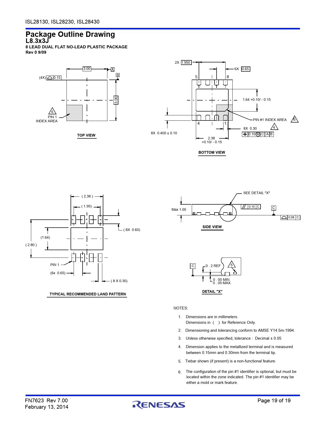

Pages / Page19 / 19 — Package Outline Drawing. L8.3x3J 8 LEAD DUAL FLAT NO-LEAD PLASTIC PACKAGE …
Revision2017-11-07
Package Outline Drawing. L8.3x3J 8 LEAD DUAL FLAT NO-LEAD PLASTIC PACKAGE Rev 0 9/09. TOP VIEW. BOTTOM VIEW. SIDE VIEW
Package Outline Drawing L8.3x3J 8 LEAD DUAL FLAT NO-LEAD PLASTIC PACKAGE Rev 0 9/09 TOP VIEW BOTTOM VIEW SIDE VIEW
ISL28130, ISL28230, ISL28430
2X 1.950 3.00 A 6X 0.65 B (4X) 0.15 5 8 0 1.64 +0.10/ - 0.15 3.0 6 PIN 1 INDEX AREA PIN #1 INDEX AREA 6 4 1 8X 0.30 4 8X 0.400 ± 0.10
TOP VIEW
0.10 M C A B 2.38 +0.10/ - 0.15
BOTTOM VIEW
SEE DETAIL "X" ( 2.38 ) ( 1.95) 0.10 C Max 1.00 C 0.08 C
SIDE VIEW
( 8X 0.60) (1.64) ( 2.80 ) PIN 1 C 0 . 2 REF 5 (6x 0.65) 0 . 00 MIN. ( 8 X 0.30) 0 . 05 MAX.
DETAIL "X" TYPICAL RECOMMENDED LAND PATTERN
NOTES: 1. Dimensions are in millimeters. Dimensions in ( ) for Reference Only. 2. Dimensioning and tolerancing conform to AMSE Y14.5m-1994. 3. Unless otherwise specified, tolerance : Decimal ± 0.05 4. Dimension applies to the metallized terminal and is measured between 0.15mm and 0.30mm from the terminal tip. 5. Tiebar shown (if present) is a non-functional feature. 6. The configuration of the pin #1 identifier is optional, but must be located within the zone indicated. The pin #1 identifier may be either a mold or mark feature. FN7623 Rev 7.00 Page 19 of 19 February 13, 2014
