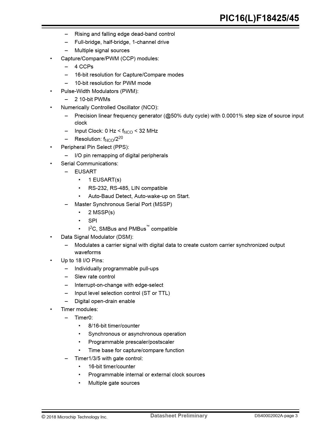

– Rising and falling edge dead-band control – Full-bridge, half-bridge, 1-channel drive – Multiple signal sources • Capture/Compare/PWM (CCP) modules: – 4 CCPs – 16-bit resolution for Capture/Compare modes – 10-bit resolution for PWM mode • Pulse-Width Modulators (PWM): – 2 10-bit PWMs • Numerically Controlled Oscillator (NCO): – Precision linear frequency generator (@50% duty cycle) with 0.0001% step size of source input clock – Input Clock: 0 Hz < fNCO < 32 MHz – Resolution: fNCO/220 • Peripheral Pin Select (PPS): – I/O pin remapping of digital peripherals • Serial Communications: – EUSART • 1 EUSART(s) • RS-232, RS-485, LIN compatible • Auto-Baud Detect, Auto-wake-up on Start. – Master Synchronous Serial Port (MSSP) • 2 MSSP(s) • SPI • I2C, SMBus and PMBus™ compatible • Data Signal Modulator (DSM): – Modulates a carrier signal with digital data to create custom carrier synchronized output waveforms • Up to 18 I/O Pins: – Individually programmable pull-ups – Slew rate control – Interrupt-on-change with edge-select – Input level selection control (ST or TTL) – Digital open-drain enable • Timer modules: – Timer0: • 8/16-bit timer/counter • Synchronous or asynchronous operation • Programmable prescaler/postscaler • Time base for capture/compare function – Timer1/3/5 with gate control: • 16-bit timer/counter • Programmable internal or external clock sources • Multiple gate sources © 2018 Microchip Technology Inc.
