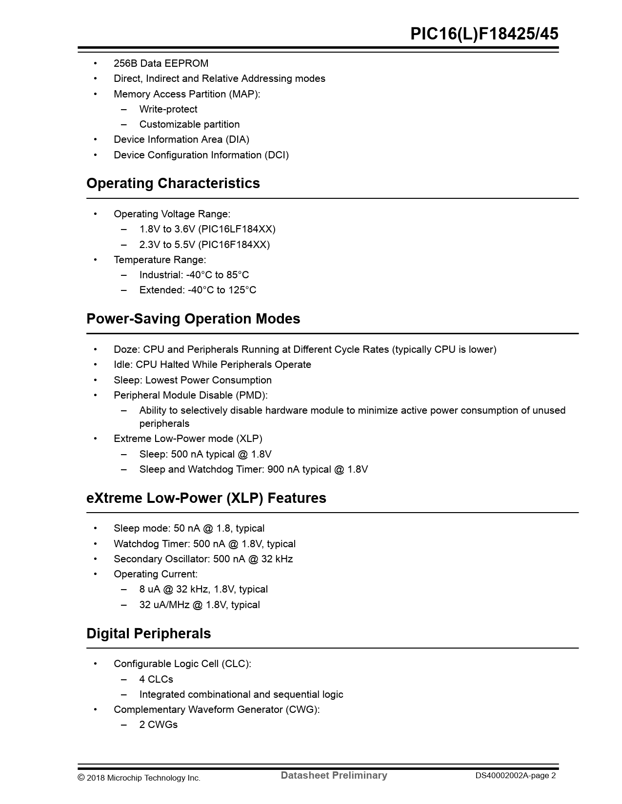

• 256B Data EEPROM • Direct, Indirect and Relative Addressing modes • Memory Access Partition (MAP): – Write-protect – Customizable partition • Device Information Area (DIA) • Device Configuration Information (DCI)
Operating Characteristics
• Operating Voltage Range: – 1.8V to 3.6V (PIC16LF184XX) – 2.3V to 5.5V (PIC16F184XX) • Temperature Range: – Industrial: -40°C to 85°C – Extended: -40°C to 125°C
Power-Saving Operation Modes
• Doze: CPU and Peripherals Running at Different Cycle Rates (typically CPU is lower) • Idle: CPU Halted While Peripherals Operate • Sleep: Lowest Power Consumption • Peripheral Module Disable (PMD): – Ability to selectively disable hardware module to minimize active power consumption of unused peripherals • Extreme Low-Power mode (XLP) – Sleep: 500 nA typical @ 1.8V – Sleep and Watchdog Timer: 900 nA typical @ 1.8V
eXtreme Low-Power (XLP) Features
• Sleep mode: 50 nA @ 1.8, typical • Watchdog Timer: 500 nA @ 1.8V, typical • Secondary Oscillator: 500 nA @ 32 kHz • Operating Current: – 8 uA @ 32 kHz, 1.8V, typical – 32 uA/MHz @ 1.8V, typical
Digital Peripherals
• Configurable Logic Cell (CLC): – 4 CLCs – Integrated combinational and sequential logic • Complementary Waveform Generator (CWG): – 2 CWGs © 2018 Microchip Technology Inc.
