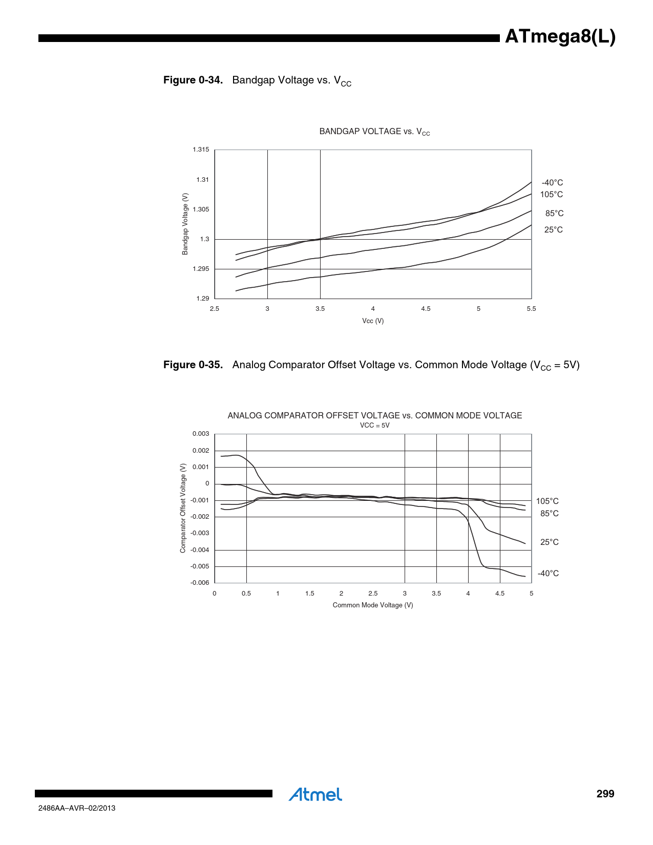

ATmega8(L) Figure 0-34.
Bandgap Voltage vs. VCC BANDGAP VOLTAGE vs. VCC 1.315 1.31 -40°C ) 105°C V 1.305 85°C 25°C 1.3 Bandgap Voltage ( 1.295 1.29 2.5 3 3.5 4 4.5 5 5.5 Vcc (V)
Figure 0-35.
Analog Comparator Offset Voltage vs. Common Mode Voltage (V = 5V) CC ANALOG COMPARATOR OFFSET VOLTAGE vs. COMMON MODE VOLTAGE VCC = 5V 0.003 0.002 ) V 0.001 0 tage ( -0.001 et Vol 105°C ffs 85°C O -0.002 -0.003 25°C -0.004 Comparator -0.005 -40°C -0.006 0 0.5 1 1.5 2 2.5 3 3.5 4 4.5 5 Common Mode Voltage (V)
