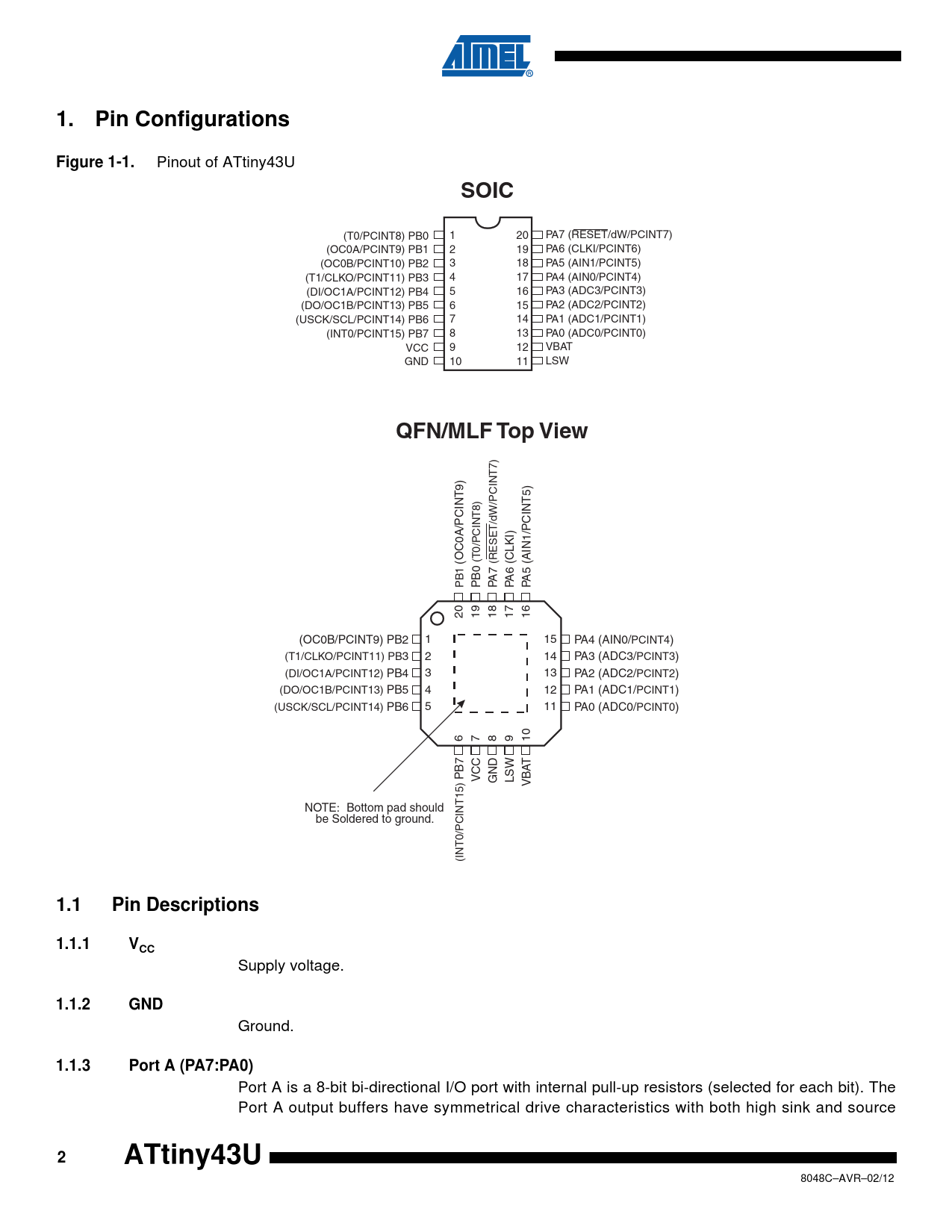

1. Pin Configurations Figure 1-1.
Pinout of ATtiny43U
SOIC
(T0/PCINT8) PB0 1 20 PA7 (RESET/dW/PCINT7) (OC0A/PCINT9) PB1 2 19 PA6 (CLKI/PCINT6) (OC0B/PCINT10) PB2 3 18 PA5 (AIN1/PCINT5) (T1/CLKO/PCINT11) PB3 4 17 PA4 (AIN0/PCINT4) (DI/OC1A/PCINT12) PB4 5 16 PA3 (ADC3/PCINT3) (DO/OC1B/PCINT13) PB5 6 15 PA2 (ADC2/PCINT2) (USCK/SCL/PCINT14) PB6 7 14 PA1 (ADC1/PCINT1) (INT0/PCINT15) PB7 8 13 PA0 (ADC0/PCINT0) VCC 9 12 VBAT GND 10 11 LSW
QFN/MLF Top View
(OC0A/PCINT9) (T0/PCINT8) (RESET/dW/PCINT7) A7 A6 (CLKI) A5 (AIN1/PCINT5) PB1 PB0 P P P 20 19 18 17 16 (OC0B/PCINT9) PB2 1 15 PA4 (AIN0/PCINT4) (T1/CLKO/PCINT11) PB3 2 14 PA3 (ADC3/PCINT3) (DI/OC1A/PCINT12) PB4 3 13 PA2 (ADC2/PCINT2) (DO/OC1B/PCINT13) PB5 4 12 PA1 (ADC1/PCINT1) (USCK/SCL/PCINT14) PB6 5 11 PA0 (ADC0/PCINT0) 6 7 8 9 10 T PB7 VCC GND LSW VBA NOTE: Bottom pad should be Soldered to ground. (INT0/PCINT15)
1.1 Pin Descriptions 1.1.1 VCC
Supply voltage.
1.1.2 GND
Ground.
1.1.3 Port A (PA7:PA0)
Port A is a 8-bit bi-directional I/O port with internal pull-up resistors (selected for each bit). The Port A output buffers have symmetrical drive characteristics with both high sink and source
