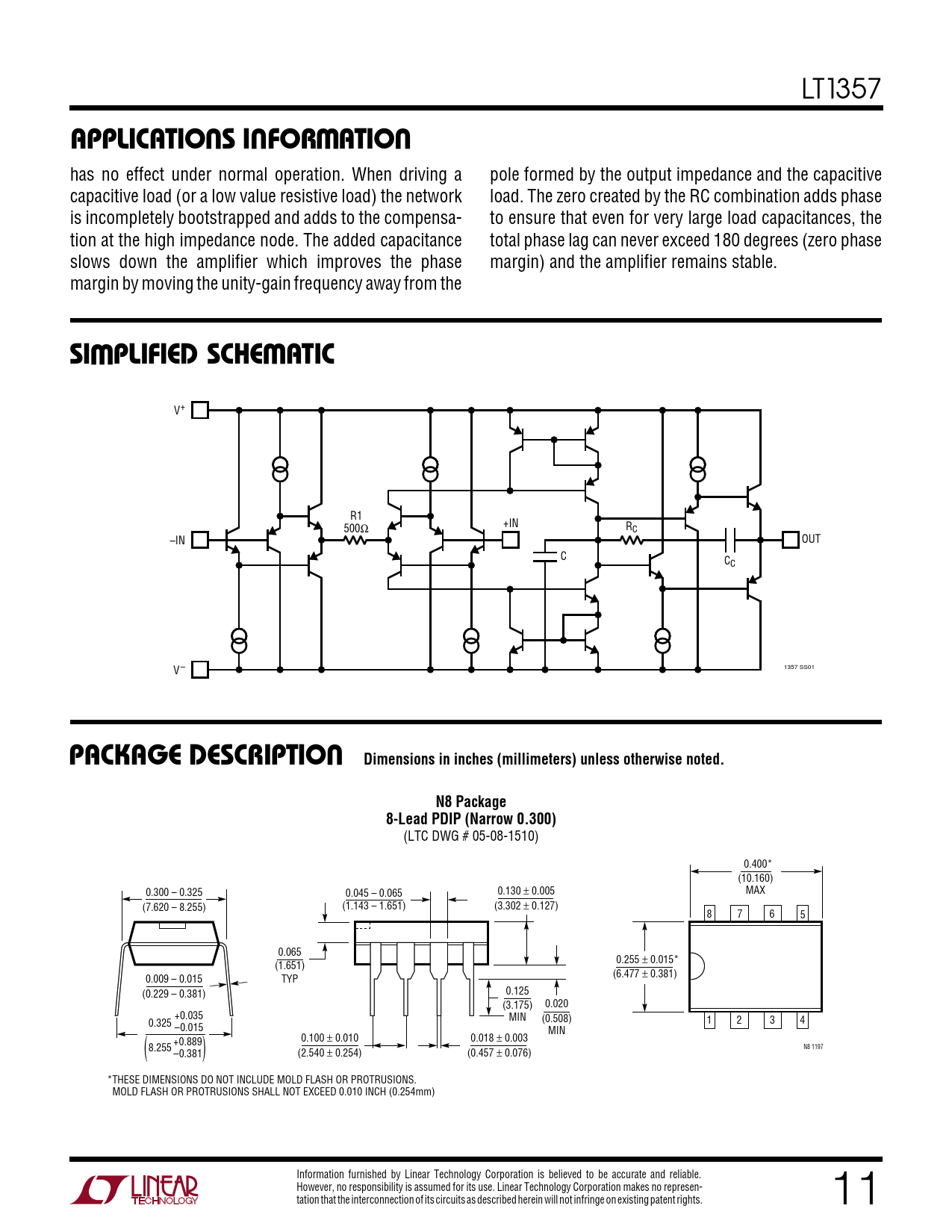

U U W U APPLICATIONS INFORMATION
has no effect under normal operation. When driving a pole formed by the output impedance and the capacitive capacitive load (or a low value resistive load) the network load. The zero created by the RC combination adds phase is incompletely bootstrapped and adds to the compensa- to ensure that even for very large load capacitances, the tion at the high impedance node. The added capacitance total phase lag can never exceed 180 degrees (zero phase slows down the amplifier which improves the phase margin) and the amplifier remains stable. margin by moving the unity-gain frequency away from the
W W I S PLI I F ED SCHE ATIC
V+ R1 +IN 500Ω RC –IN OUT C CC 1357 SS01 V–
