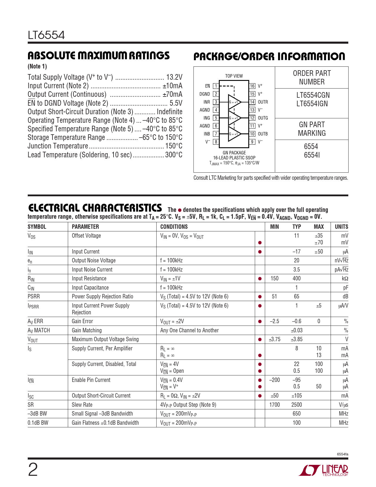

ABSOLUTE AXI U. RATI GS. PACKAGE/ORDER I FOR ATIO. (Note 1). ELECTRICAL CHARACTERISTICS The
ABSOLUTE AXI U RATI GS PACKAGE/ORDER I FOR ATIO (Note 1) ELECTRICAL CHARACTERISTICS The
LT6554
W W W U U W U ABSOLUTE AXI U RATI GS PACKAGE/ORDER I FOR ATIO (Note 1)
ORDER PART TOP VIEW Total Supply Voltage (V+ to V–) .. 13.2V NUMBER Input Current (Note 2) .. EN 1 16 V+ ±10mA DGND 2 15 V+ Output Current (Continuous) ... ±70mA LT6554CGN INR 3 G = +1 14 OUTR EN to DGND Voltage (Note 2) ... 5.5V LT6554IGN AGND 4 13 V– Output Short-Circuit Duration (Note 3) .. Indefinite ING 5 G = +1 12 OUTG Operating Temperature Range (Note 4) ... –40°C to 85°C AGND 6 11 V+ GN PART Specified Temperature Range (Note 5) .. –40°C to 85°C INB 7 G = +1 10 OUTB MARKING Storage Temperature Range .. –65°C to 150°C V– 8 9 V– Junction Temperature ... 150°C 6554 GN PACKAGE Lead Temperature (Soldering, 10 sec).. 300°C 6554I 16-LEAD PLASTIC SSOP TJMAX = 150°C, θJA = 135°C/W Consult LTC Marketing for parts specified with wider operating temperature ranges.
C. VS =
5V, RL = 1k, CL = 1.5pF, VEN = 0.4V, VAGND, VDGND = 0V. SYMBOL PARAMETER CONDITIONS MIN TYP MAX UNITS
VOS Offset Voltage VIN = 0V, VOS = VOUT 11 ±35 mV ● ±70 mV IIN Input Current ● –17 ±50 µA en Output Noise Voltage f = 100kHz 20 nV√Hz in Input Noise Current f = 100kHz 3.5 pA√Hz RIN Input Resistance VIN = ±1V ● 150 400 kΩ CIN Input Capacitance f = 100kHz 1 pF PSRR Power Supply Rejection Ratio VS (Total) = 4.5V to 12V (Note 6) ● 51 65 dB IPSRR Input Current Power Supply VS (Total) = 4.5V to 12V (Note 6) ● 1 ±5 µA/V Rejection AV ERR Gain Error VOUT = ±2V ● –2.5 –0.6 0 % AV MATCH Gain Matching Any One Channel to Another ±0.03 % VOUT Maximum Output Voltage Swing ● ±3.75 ±3.85 V IS Supply Current, Per Amplifier RL = ∞ 8 10 mA RL = ∞ ● 13 mA Supply Current, Disabled, Total VEN = 4V ● 22 100 µA VEN = Open ● 0.5 100 µA IEN Enable Pin Current VEN = 0.4V ● –200 –95 µA VEN = V+ ● 0.5 50 µA ISC Output Short-Circuit Current RL = 0Ω, VIN = ±2V ● ±50 ±105 mA SR Slew Rate 4VP-P Output Step (Note 9) 1700 2500 V/µs –3dB BW Small Signal –3dB Bandwidth VOUT = 200mVP-P 650 MHz 0.1dB BW Gain Flatness ±0.1dB Bandwidth VOUT = 200mVP-P 100 MHz 6554fa 2
