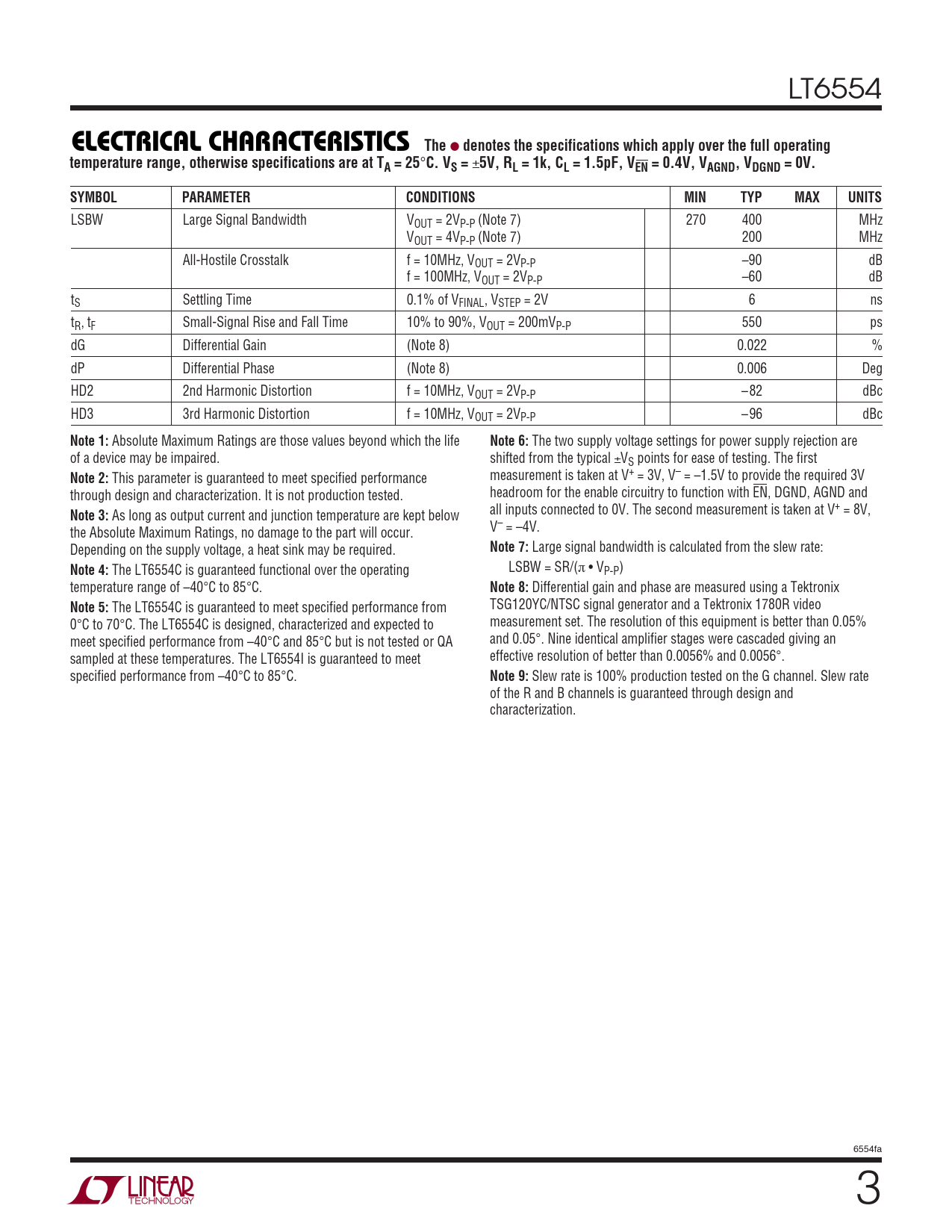

ELECTRICAL CHARACTERISTICS The. denotes the specifications which apply over the full operating
LT6554
C. VS =
5V, RL = 1k, CL = 1.5pF, VEN = 0.4V, VAGND, VDGND = 0V. SYMBOL PARAMETER CONDITIONS MIN TYP MAX UNITS
LSBW Large Signal Bandwidth VOUT = 2VP-P (Note 7) 270 400 MHz VOUT = 4VP-P (Note 7) 200 MHz All-Hostile Crosstalk f = 10MHz, VOUT = 2VP-P –90 dB f = 100MHz, VOUT = 2VP-P –60 dB tS Settling Time 0.1% of VFINAL, VSTEP = 2V 6 ns tR, tF Small-Signal Rise and Fall Time 10% to 90%, VOUT = 200mVP-P 550 ps dG Differential Gain (Note 8) 0.022 % dP Differential Phase (Note 8) 0.006 Deg HD2 2nd Harmonic Distortion f = 10MHz, VOUT = 2VP-P –82 dBc HD3 3rd Harmonic Distortion f = 10MHz, VOUT = 2VP-P –96 dBc
Note 1:
Absolute Maximum Ratings are those values beyond which the life
Note 6:
The two supply voltage settings for power supply rejection are of a device may be impaired. shifted from the typical ±VS points for ease of testing. The first
Note 2:
This parameter is guaranteed to meet specified performance measurement is taken at V+ = 3V, V– = –1.5V to provide the required 3V through design and characterization. It is not production tested. headroom for the enable circuitry to function with EN, DGND, AGND and
Note 3:
As long as output current and junction temperature are kept below all inputs connected to 0V. The second measurement is taken at V+ = 8V, the Absolute Maximum Ratings, no damage to the part will occur. V– = –4V. Depending on the supply voltage, a heat sink may be required.
Note 7:
Large signal bandwidth is calculated from the slew rate:
Note 4:
The LT6554C is guaranteed functional over the operating LSBW = SR/(π • VP-P) temperature range of –40°C to 85°C.
Note 8:
Differential gain and phase are measured using a Tektronix
Note 5:
The LT6554C is guaranteed to meet specified performance from TSG120YC/NTSC signal generator and a Tektronix 1780R video 0°C to 70°C. The LT6554C is designed, characterized and expected to measurement set. The resolution of this equipment is better than 0.05% meet specified performance from –40°C and 85°C but is not tested or QA and 0.05°. Nine identical amplifier stages were cascaded giving an sampled at these temperatures. The LT6554I is guaranteed to meet effective resolution of better than 0.0056% and 0.0056°. specified performance from –40°C to 85°C.
Note 9:
Slew rate is 100% production tested on the G channel. Slew rate of the R and B channels is guaranteed through design and characterization. 6554fa 3
