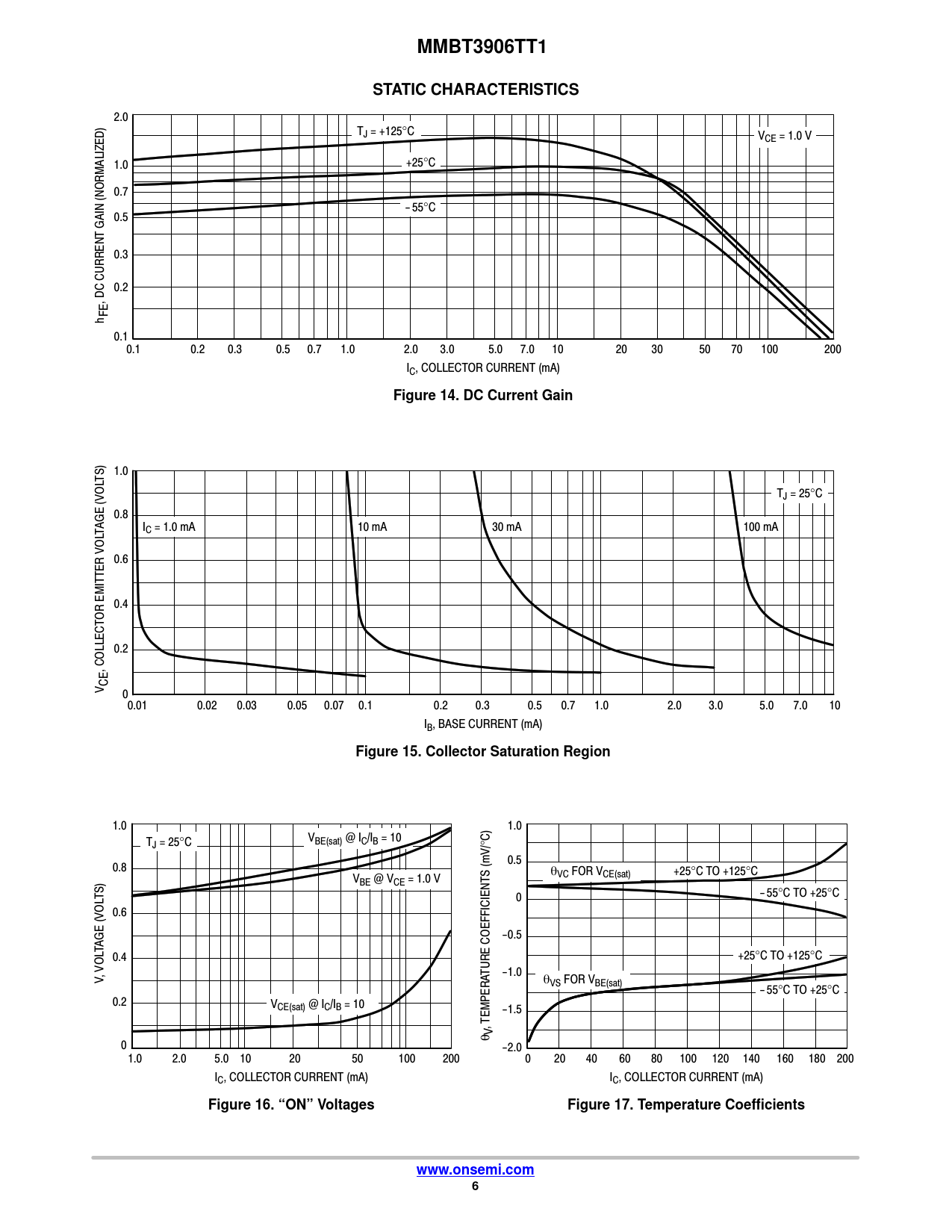

MMBT3906TT1. STATIC CHARACTERISTICS. Figure 14. DC Current Gain. Figure 15. Collector Saturation Region
MMBT3906TT1 STATIC CHARACTERISTICS Figure 14 DC Current Gain Figure 15 Collector Saturation Region
2.0 TJ = +125°C VCE = 1.0 V 1.0 +25°C 0.7 -55°C 0.5 GAIN (NORMALIZED) 0.3 0.2 FEh , DC CURRENT 0.1 0.1 0.2 0.3 0.5 0.7 1.0 2.0 3.0 5.0 7.0 10 20 30 50 70 100 200 IC, COLLECTOR CURRENT (mA)
1.0 TS) TJ = 25°C 0.8 TAGE (VOL IC = 1.0 mA 10 mA 30 mA 100 mA 0.6 0.4 OR EMITTER VOL 0.2 CEV , COLLECT 00.01 0.02 0.03 0.05 0.07 0.1 0.2 0.3 0.5 0.7 1.0 2.0 3.0 5.0 7.0 10 IB, BASE CURRENT (mA)
1.0 1.0 T C) J = 25°C VBE(sat) @ IC/IB = 10 ° 0.5 0.8 q +25 VC FOR VCE(sat) °C TO +125°C VBE @ VCE = 1.0 V TS) 0 -55°C TO +25°C 0.6 -0.5 TAGE (VOL 0.4 +25°C TO +125°C , VOL TURE COEFFICIENTS (mV/ -1.0 V qVS FOR VBE(sat) -55°C TO +25°C 0.2 VCE(sat) @ IC/IB = 10 -1.5 , TEMPERA Vθ 0 -2.0 1.0 2.0 5.0 10 20 50 100 200 0 20 40 60 80 100 120 140 160 180 200 IC, COLLECTOR CURRENT (mA) IC, COLLECTOR CURRENT (mA)
Figure 16. “ON” Voltages Figure 17. Temperature Coefficients www.onsemi.com 6
