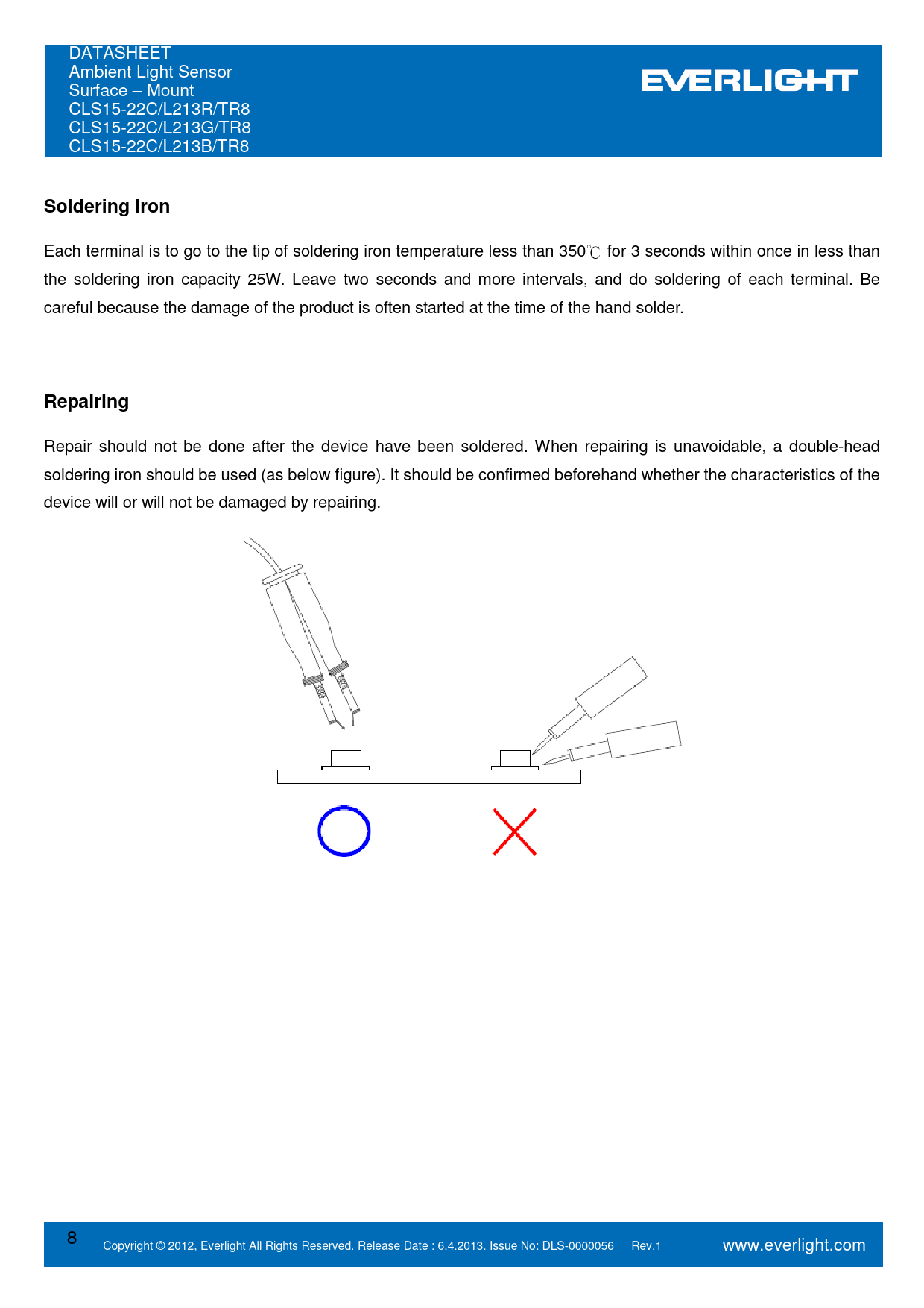

DATASHEET Ambient Light Sensor Surface – Mount CLS15-22C/L213R/TR8 CLS15-22C/L213G/TR8 CLS15-22C/L213B/TR8
Soldering Iron
Each terminal is to go to the tip of soldering iron temperature less than 350℃ for 3 seconds within once in less than the soldering iron capacity 25W. Leave two seconds and more intervals, and do soldering of each terminal. Be careful because the damage of the product is often started at the time of the hand solder.
Repairing
Repair should not be done after the device have been soldered. When repairing is unavoidable, a double-head soldering iron should be used (as below figure). It should be confirmed beforehand whether the characteristics of the device will or will not be damaged by repairing. 8 Copyright © 2012, Everlight All Rights Reserved. Release Date : 6.4.2013. Issue No: DLS-0000056 Rev.1 www.everlight.com
