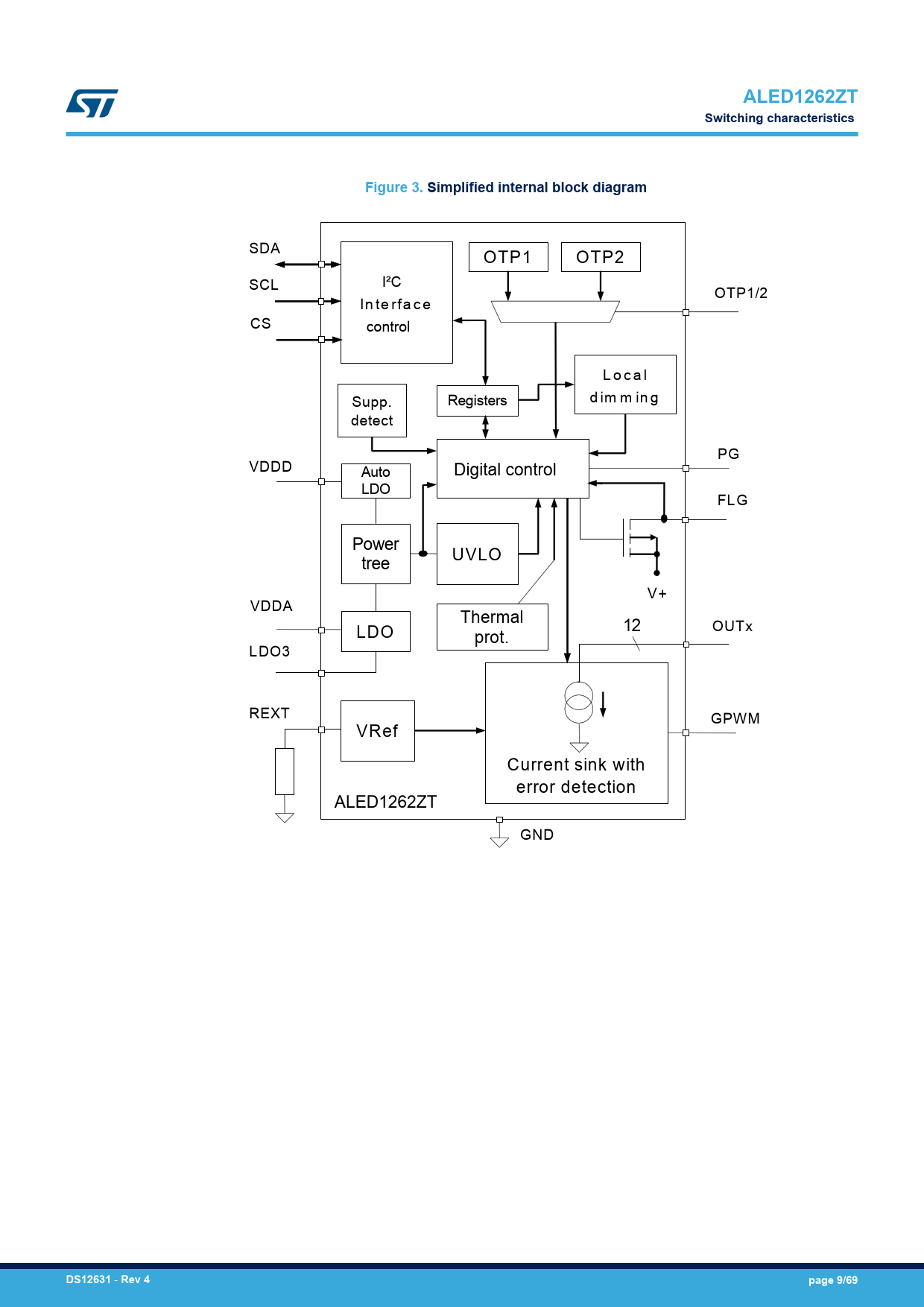

ALED1262ZT. Switching characteristics. Figure 3. Simplified internal block diagram. DS12631. Rev 4. page 9/69
ALED1262ZT Switching characteristics Figure 3. Simplified internal block diagram
SDA OTP1 OTP2 SCL I²C OTP1/2 In te rfa c e CS control L o c a l d im m in g Supp. Registers detect PG VDDD Auto Digital control LDO FLG Power tree UVLO V+ VDDA Thermal 12 OUTx LDO prot. LDO3 REXT GPWM VRef Current sink with error detection ALED1262ZT GND
