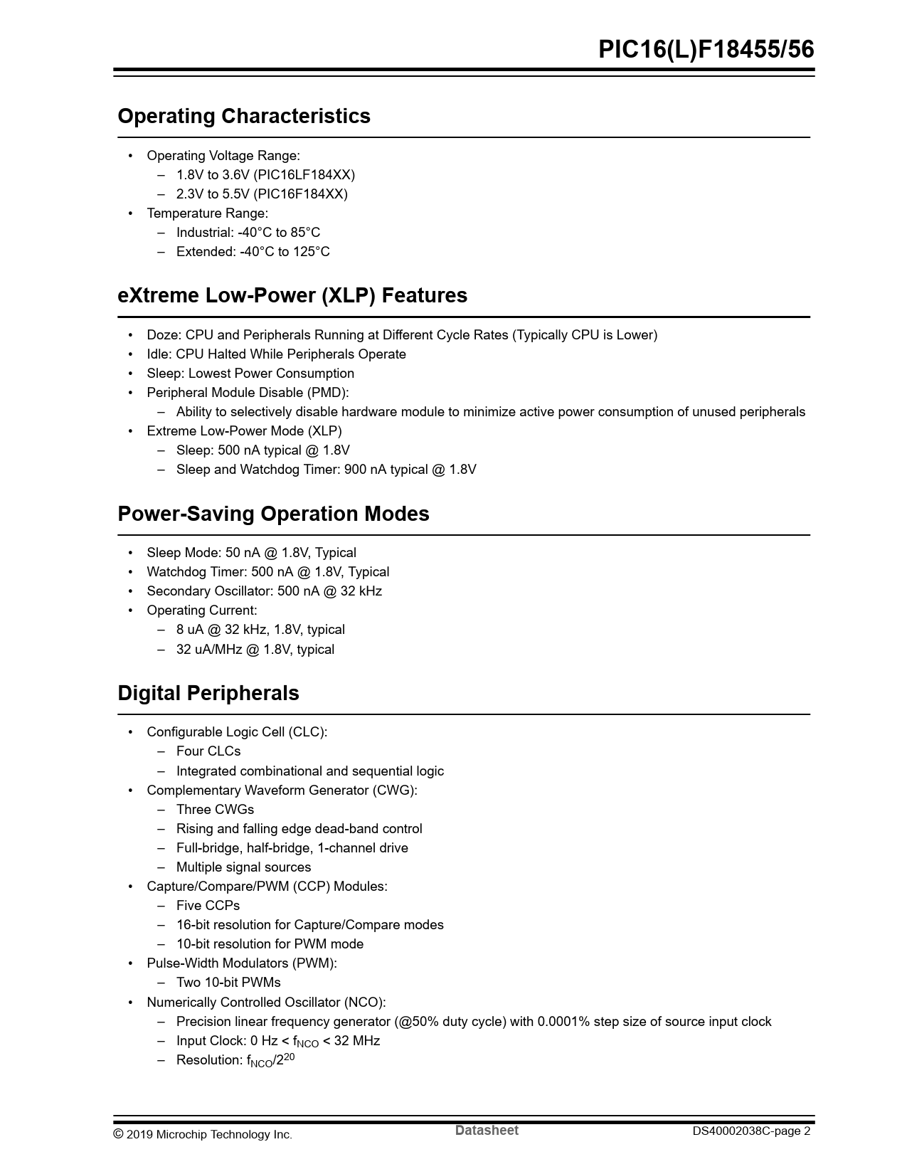

PIC16(L)F18455/56 Operating Characteristics
• Operating Voltage Range: – 1.8V to 3.6V (PIC16LF184XX) – 2.3V to 5.5V (PIC16F184XX) • Temperature Range: – Industrial: -40°C to 85°C – Extended: -40°C to 125°C
eXtreme Low-Power (XLP) Features
• Doze: CPU and Peripherals Running at Different Cycle Rates (Typically CPU is Lower) • Idle: CPU Halted While Peripherals Operate • Sleep: Lowest Power Consumption • Peripheral Module Disable (PMD): – Ability to selectively disable hardware module to minimize active power consumption of unused peripherals • Extreme Low-Power Mode (XLP) – Sleep: 500 nA typical @ 1.8V – Sleep and Watchdog Timer: 900 nA typical @ 1.8V
Power-Saving Operation Modes
• Sleep Mode: 50 nA @ 1.8V, Typical • Watchdog Timer: 500 nA @ 1.8V, Typical • Secondary Oscillator: 500 nA @ 32 kHz • Operating Current: – 8 uA @ 32 kHz, 1.8V, typical – 32 uA/MHz @ 1.8V, typical
Digital Peripherals
• Configurable Logic Cell (CLC): – Four CLCs – Integrated combinational and sequential logic • Complementary Waveform Generator (CWG): – Three CWGs – Rising and falling edge dead-band control – Full-bridge, half-bridge, 1-channel drive – Multiple signal sources • Capture/Compare/PWM (CCP) Modules: – Five CCPs – 16-bit resolution for Capture/Compare modes – 10-bit resolution for PWM mode • Pulse-Width Modulators (PWM): – Two 10-bit PWMs • Numerically Controlled Oscillator (NCO): – Precision linear frequency generator (@50% duty cycle) with 0.0001% step size of source input clock – Input Clock: 0 Hz < fNCO < 32 MHz – Resolution: fNCO/220 © 2019 Microchip Technology Inc.
