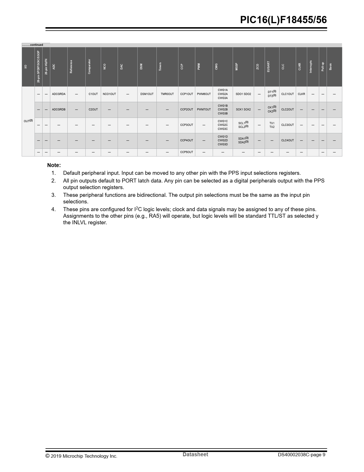

PIC16(L)F18455/56. ...continued. I/O. ADC. NCO. DAC. DSM. imers. CCP. CLC. PWM. CWG. MSSP. ZCD. CLKR. Pull-up. Basic. Reference. EUSART. Interrupts
PIC16(L)F18455/56 ...continued I/O ADC NCO DAC DSM imers CCP CLC T PWM CWG MSSP ZCD CLKR Pull-up Basic Reference EUSART Interrupts 28-pin VQFN Comparator 28-pin SPDIP/SOIC/SSOP
CWG1A DT1
(3)
— — ADCGRDA — C1OUT NCO1OUT — DSM1OUT TMR0OUT CCP1OUT PWM6OUT CWG2A SDO1 SDO2 — DT2
(3)
CLC1OUT CLKR — — — CWG3A CWG1B CK1
(3)
— — ADCGRDB — C2OUT — — — — CCP2OUT PWM7OUT CWG2B SCK1 SCK2 — CK2
(3)
CLC2OUT — — — — CWG3B OUT
(2)
CWG1C SCL1
(3)
TX1 — — — — — — — — — CCP3OUT — CWG2C CLC3OUT — — — — SCL2
(3)
— TX2 CWG3C CWG1D SDA1
(3)
— — — — — — — — — CCP4OUT — CWG2D SDA2
(3)
— — CLC4OUT — — — — CWG3D — — — — — — — — — CCP5OUT — — — — — — — — —
Note:
1. Default peripheral input. Input can be moved to any other pin with the PPS input selections registers. 2. All pin outputs default to PORT latch data. Any pin can be selected as a digital peripherals output with the PPS output selection registers. 3. These peripheral functions are bidirectional. The output pin selections must be the same as the input pin selections. 4. These pins are configured for I2C logic levels; clock and data signals may be assigned to any of these pins. Assignments to the other pins (e.g., RA5) will operate, but logic levels will be standard TTL/ST as selected y the INLVL register. © 2019 Microchip Technology Inc.
