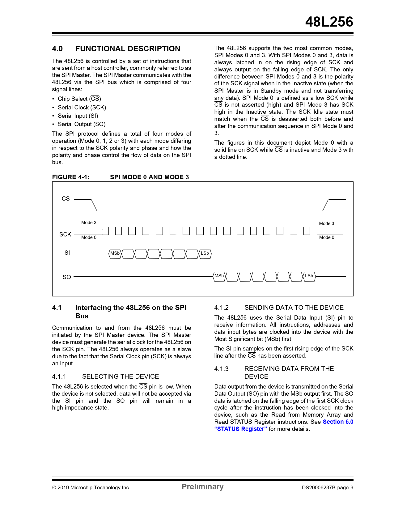

48L256 4.0 FUNCTIONAL DESCRIPTION
The 48L256 supports the two most common modes, SPI Modes 0 and 3. With SPI Modes 0 and 3, data is The 48L256 is controlled by a set of instructions that always latched in on the rising edge of SCK and are sent from a host controller, commonly referred to as always output on the falling edge of SCK. The only the SPI Master. The SPI Master communicates with the difference between SPI Modes 0 and 3 is the polarity 48L256 via the SPI bus which is comprised of four of the SCK signal when in the Inactive state (when the signal lines: SPI Master is in Standby mode and not transferring • Chip Select (CS) any data). SPI Mode 0 is defined as a low SCK while • Serial Clock (SCK) CS is not asserted (high) and SPI Mode 3 has SCK high in the Inactive state. The SCK Idle state must • Serial Input (SI) match when the CS is deasserted both before and • Serial Output (SO) after the communication sequence in SPI Mode 0 and The SPI protocol defines a total of four modes of 3. operation (Mode 0, 1, 2 or 3) with each mode differing The figures in this document depict Mode 0 with a in respect to the SCK polarity and phase and how the solid line on SCK while CS is inactive and Mode 3 with polarity and phase control the flow of data on the SPI a dotted line. bus.
FIGURE 4-1: SPI MODE 0 AND MODE 3
CS Mode 3 Mode 3 SCK Mode 0 Mode 0 SI MSb LSb SO MSb LSb
4.1 Interfacing the 48L256 on the SPI
4.1.2 SENDING DATA TO THE DEVICE
Bus
The 48L256 uses the Serial Data Input (SI) pin to receive information. All instructions, addresses and Communication to and from the 48L256 must be data input bytes are clocked into the device with the initiated by the SPI Master device. The SPI Master device must generate the serial clock for the 48L256 on Most Significant bit (MSb) first. the SCK pin. The 48L256 always operates as a slave The SI pin samples on the first rising edge of the SCK due to the fact that the Serial Clock pin (SCK) is always line after the CS has been asserted. an input. 4.1.3 RECEIVING DATA FROM THE 4.1.1 SELECTING THE DEVICE DEVICE The 48L256 is selected when the CS pin is low. When Data output from the device is transmitted on the Serial the device is not selected, data will not be accepted via Data Output (SO) pin with the MSb output first. The SO the SI pin and the SO pin will remain in a data is latched on the falling edge of the first SCK clock high-impedance state. cycle after the instruction has been clocked into the device, such as the Read from Memory Array and Read STATUS Register instructions. See
Section 6.0 “STATUS Register”
for more details.  2019 Microchip Technology Inc.
