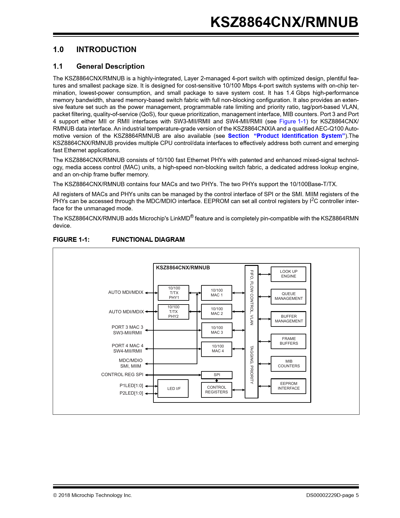

KSZ8864CNX/RMNUB 1.0 INTRODUCTION 1.1 General Description
The KSZ8864CNX/RMNUB is a highly-integrated, Layer 2-managed 4-port switch with optimized design, plentiful fea- tures and smallest package size. It is designed for cost-sensitive 10/100 Mbps 4-port switch systems with on-chip ter- mination, lowest-power consumption, and small package to save system cost. It has 1.4 Gbps high-performance memory bandwidth, shared memory-based switch fabric with full non-blocking configuration. It also provides an exten- sive feature set such as the power management, programmable rate limiting and priority ratio, tag/port-based VLAN, packet filtering, quality-of-service (QoS), four queue prioritization, management interface, MIB counters. Port 3 and Port 4 support either MII or RMII interfaces with SW3-MII/RMII and SW4-MII/RMII (see Figure 1-1) for KSZ8864CNX/ RMNUB data interface. An industrial temperature-grade version of the KSZ8864CNXIA and a qualified AEC-Q100 Auto- motive version of the KSZ8864RMNUB are also available (see
Section “Product Identification System”
).The KSZ8864CNX/RMNUB provides multiple CPU control/data interfaces to effectively address both current and emerging fast Ethernet applications. The KSZ8864CNX/RMNUB consists of 10/100 fast Ethernet PHYs with patented and enhanced mixed-signal technol- ogy, media access control (MAC) units, a high-speed non-blocking switch fabric, a dedicated address lookup engine, and an on-chip frame buffer memory. The KSZ8864CNX/RMNUB contains four MACs and two PHYs. The two PHYs support the 10/100Base-T/TX. All registers of MACs and PHYs units can be managed by the control interface of SPI or the SMI. MIIM registers of the PHYs can be accessed through the MDC/MDIO interface. EEPROM can set all control registers by I2C controller inter- face for the unmanaged mode. The KSZ8864CNX/RMNUB adds Microchip's LinkMD® feature and is completely pin-compatible with the KSZ8864RMN device.
FIGURE 1-1: FUNCTIONAL DIAGRAM KSZ8864CNX/RMNUB
FIFO, FLOW CONTROL, VLAN LOOK UP ENGINE 10/100 10/100 AUTO MDI/MDIX T/TX MAC 1 QUEUE PHY1 MANAGEMENT 10/100 10/100 AUTO MDI/MDIX T/TX MAC 2 PHY2 BUFFER MANAGEMENT PORT 3 MAC 3 10/100 SW3-MII/RMII MAC 3 FRAME PORT 4 MAC 4 T BUFFERS 10/100 AGGING, PRIORITY SW4-MII/RMII MAC 4 MDC/MDIO MIB SMI, MIIM COUNTERS CONTROL REG SPI SPI P1LED[1:0] EEPROM LED I/F CONTROL INTERFACE P2LED[1:0] REGISTERS  2018 Microchip Technology Inc.
