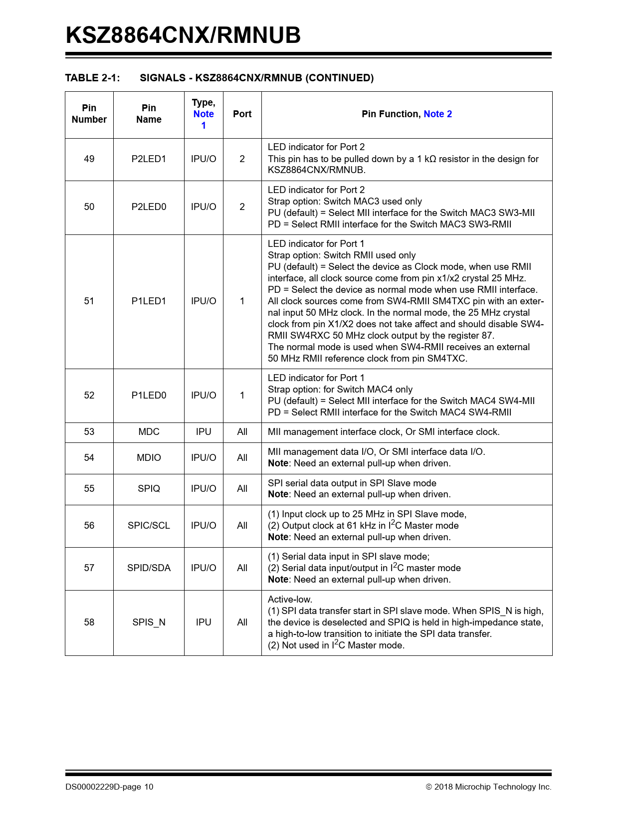

KSZ8864CNX/RMNUB. TABLE 2-1:. SIGNALS - KSZ8864CNX/RMNUB (CONTINUED). Type,. Pin. Note. Port. Pin Function, Note 2. Number. Name
KSZ8864CNX/RMNUB TABLE 2-1: SIGNALS - KSZ8864CNX/RMNUB (CONTINUED) Type, Pin Note Port Pin Function, Note 2 Number Name
KSZ8864CNX/RMNUB TABLE 2-1: SIGNALS - KSZ8864CNX/RMNUB (CONTINUED) Type, Pin Pin Note Port Pin Function, Note 2 Number Name 1
LED indicator for Port 2 49 P2LED1 IPU/O 2 This pin has to be pulled down by a 1 kΩ resistor in the design for KSZ8864CNX/RMNUB. LED indicator for Port 2 Strap option: Switch MAC3 used only 50 P2LED0 IPU/O 2 PU (default) = Select MII interface for the Switch MAC3 SW3-MII PD = Select RMII interface for the Switch MAC3 SW3-RMII LED indicator for Port 1 Strap option: Switch RMII used only PU (default) = Select the device as Clock mode, when use RMII interface, all clock source come from pin x1/x2 crystal 25 MHz. PD = Select the device as normal mode when use RMII interface. 51 P1LED1 IPU/O 1 All clock sources come from SW4-RMII SM4TXC pin with an exter- nal input 50 MHz clock. In the normal mode, the 25 MHz crystal clock from pin X1/X2 does not take affect and should disable SW4- RMII SW4RXC 50 MHz clock output by the register 87. The normal mode is used when SW4-RMII receives an external 50 MHz RMII reference clock from pin SM4TXC. LED indicator for Port 1 Strap option: for Switch MAC4 only 52 P1LED0 IPU/O 1 PU (default) = Select MII interface for the Switch MAC4 SW4-MII PD = Select RMII interface for the Switch MAC4 SW4-RMII 53 MDC IPU All MII management interface clock, Or SMI interface clock. MII management data I/O, Or SMI interface data I/O. 54 MDIO IPU/O All
Note
: Need an external pull-up when driven. SPI serial data output in SPI Slave mode 55 SPIQ IPU/O All
Note
: Need an external pull-up when driven. (1) Input clock up to 25 MHz in SPI Slave mode, 56 SPIC/SCL IPU/O All (2) Output clock at 61 kHz in I2C Master mode
Note
: Need an external pull-up when driven. (1) Serial data input in SPI slave mode; 57 SPID/SDA IPU/O All (2) Serial data input/output in I2C master mode
Note
: Need an external pull-up when driven. Active-low. (1) SPI data transfer start in SPI slave mode. When SPIS_N is high, 58 SPIS_N IPU All the device is deselected and SPIQ is held in high-impedance state, a high-to-low transition to initiate the SPI data transfer. (2) Not used in I2C Master mode. DS00002229D-page 10
