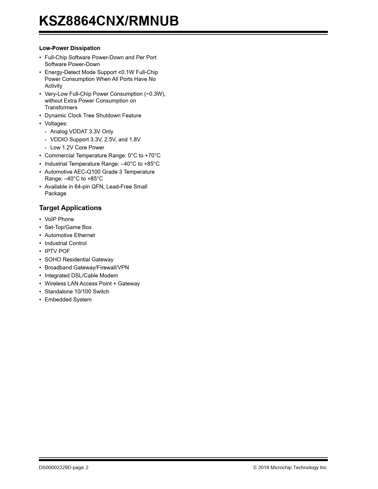

• Full-Chip Software Power-Down and Per Port Software Power-Down • Energy-Detect Mode Support <0.1W Full-Chip Power Consumption When All Ports Have No Activity • Very-Low Full-Chip Power Consumption (~0.3W), without Extra Power Consumption on Transformers • Dynamic Clock Tree Shutdown Feature • Voltages: - Analog VDDAT 3.3V Only - VDDIO Support 3.3V, 2.5V, and 1.8V - Low 1.2V Core Power • Commercial Temperature Range: 0°C to +70°C • Industrial Temperature Range: –40°C to +85°C • Automotive AEC-Q100 Grade 3 Temperature Range: –40°C to +85°C • Available in 64-pin QFN, Lead-Free Small Package
Target Applications
• VoIP Phone • Set-Top/Game Box • Automotive Ethernet • Industrial Control • IPTV POF • SOHO Residential Gateway • Broadband Gateway/Firewall/VPN • Integrated DSL/Cable Modem • Wireless LAN Access Point + Gateway • Standalone 10/100 Switch • Embedded System DS00002229D-page 2
