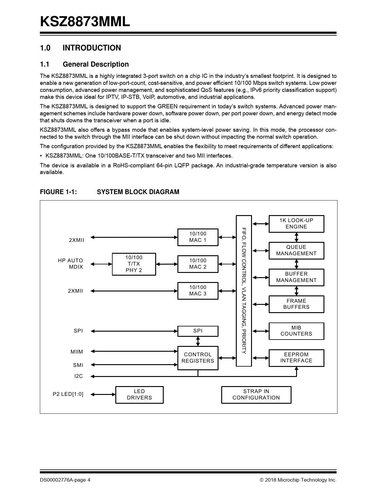

KSZ8873MML. 1.0. INTRODUCTION. 1.1. General Description. FIGURE 1-1:. SYSTEM BLOCK DIAGRAM
KSZ8873MML 1.0 INTRODUCTION 1.1 General Description FIGURE 1-1: SYSTEM BLOCK DIAGRAM
The KSZ8873MML is a highly integrated 3-port switch on a chip IC in the industry’s smallest footprint. It is designed to enable a new generation of low-port-count, cost-sensitive, and power efficient 10/100 Mbps switch systems. Low power consumption, advanced power management, and sophisticated QoS features (e.g., IPv6 priority classification support) make this device ideal for IPTV, IP-STB, VoIP, automotive, and industrial applications. The KSZ8873MML is designed to support the GREEN requirement in today’s switch systems. Advanced power man- agement schemes include hardware power down, software power down, per port power down, and energy detect mode that shuts downs the transceiver when a port is idle. KSZ8873MML also offers a bypass mode that enables system-level power saving. In this mode, the processor con- nected to the switch through the MII interface can be shut down without impacting the normal switch operation. The configuration provided by the KSZ8873MML enables the flexibility to meet requirements of different applications: • KSZ8873MML: One 10/100BASE-T/TX transceiver and two MII interfaces. The device is available in a RoHS-compliant 64-pin LQFP package. An industrial-grade temperature version is also available.
1K LOOK-UP F ENGINE FI 10/100 O 2XMII MAC 1 F , L O QUEUE W MANAGEMENT 10/100 C HP AUTO 10/100 O T/TX N MDIX MAC 2 T PHY 2 R BUFFER O L MANAGEMENT V , 10/100 L 2XMII A MAC 3 N T FRAME A G BUFFERS G NI G P , MIB SPI SPI R COUNTERS OI R TI Y MIIM CONTROL EEPROM REGISTERS INTERFACE SMI I2C LED STRAP IN P2 LED[1:0] DRIVERS CONFIGURATION DS00002776A-page 4
