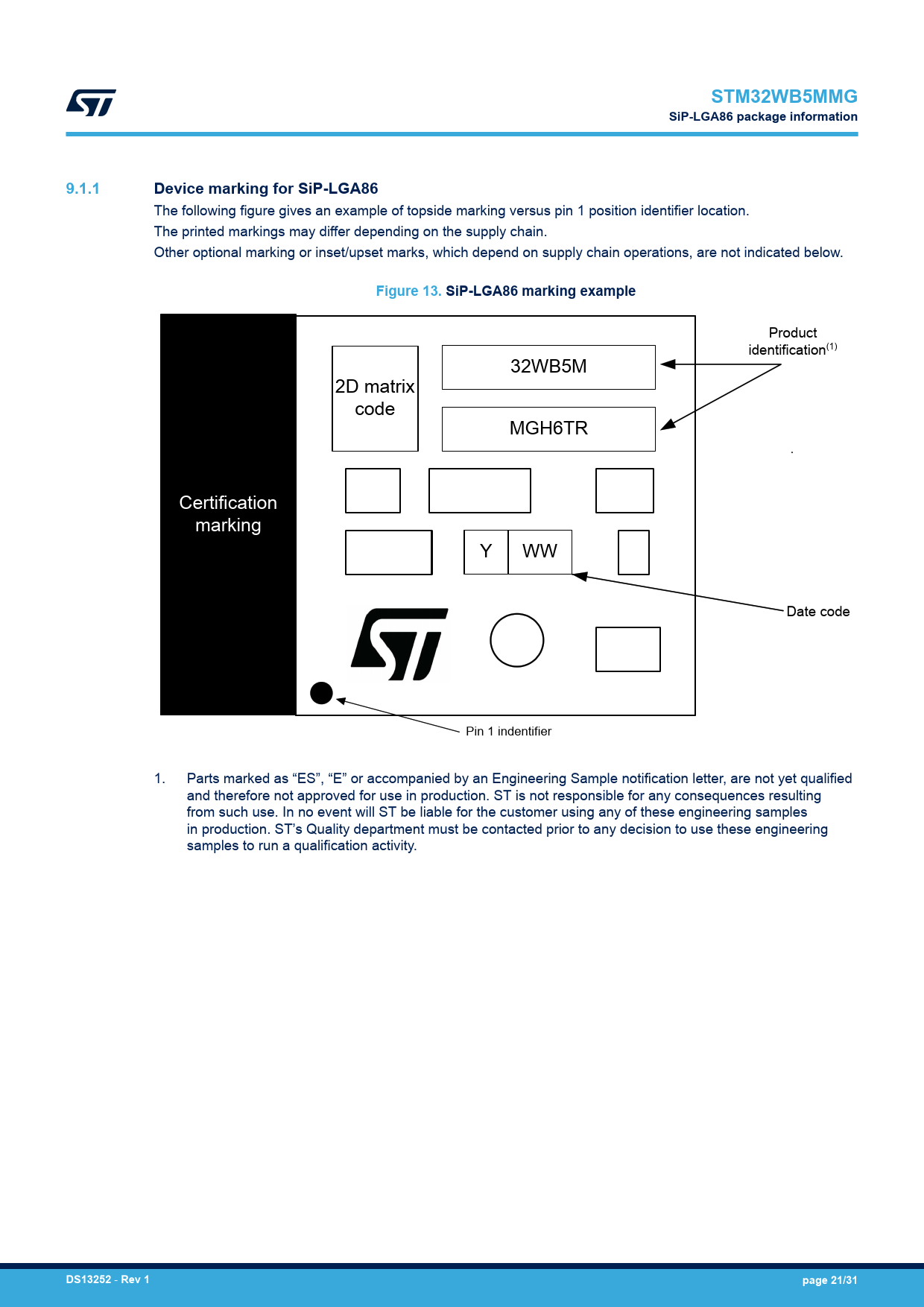

STM32WB5MMG SiP-LGA86 package information 9.1.1 Device marking for SiP-LGA86
The following figure gives an example of topside marking versus pin 1 position identifier location. The printed markings may differ depending on the supply chain. Other optional marking or inset/upset marks, which depend on supply chain operations, are not indicated below.
Figure 13. SiP-LGA86 marking example
Product identification(1) 32WB5M 2D matrix code MGH6TR Certification marking Y WW Date code Pin 1 indentifier 1. Parts marked as “ES”, “E” or accompanied by an Engineering Sample notification letter, are not yet qualified and therefore not approved for use in production. ST is not responsible for any consequences resulting from such use. In no event will ST be liable for the customer using any of these engineering samples in production. ST’s Quality department must be contacted prior to any decision to use these engineering samples to run a qualification activity.
