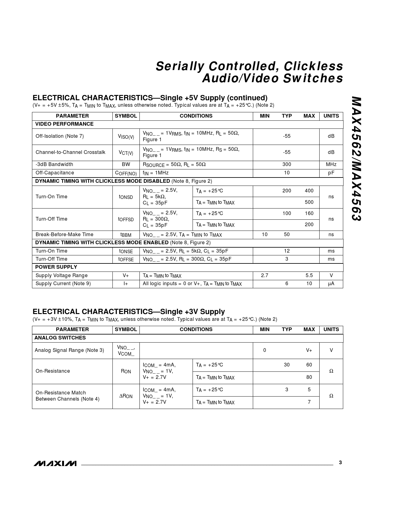

Serially Controlled, Clickless Audio/Video Switches MAX4562/MAX4563 ELECTRICAL CHARACTERISTICS—Single +5V Supply (continued)
(V+ = +5V ±5%, TA = TMIN to TMAX, unless otherwise noted. Typical values are at TA = +25°C.) (Note 2)
PARAMETER SYMBOL CONDITIONS MIN TYP MAX UNITS VIDEO PERFORMANCE
VNO_ _ = 1VRMS, fIN = 10MHz, RL = 50Ω, Off-Isolation (Note 7) VISO(V) -55 dB Figure 1 VNO_ _ = 1VRMS, fIN = 10MHz, RS = 50Ω, Channel-to-Channel Crosstalk VCT(V) -55 dB Figure 1 -3dB Bandwidth BW RSOURCE = 50Ω, RL = 50Ω 300 MHz Off-Capacitance COFF(NO) fIN = 1MHz 10 pF
DYNAMIC TIMING WITH CLICKLESS MODE DISABLED
(Note 8, Figure 2) VNO_ _ = 2.5V, TA = +25°C 200 400 Turn-On Time tONSD RL = 5kΩ, ns CL = 35pF TA = TMIN to TMAX 500 VNO_ _ = 2.5V, TA = +25°C 100 160 Turn-Off Time tOFFSD RL = 300Ω, ns C T L = 35pF A = TMIN to TMAX 200 Break-Before-Make Time tBBM VNO_ _ = 2.5V, TA = TMIN to TMAX 10 50 ns
DYNAMIC TIMING WITH CLICKLESS MODE ENABLED
(Note 8, Figure 2) Turn-On Time tONSE VNO_ _ = 2.5V, RL = 5kΩ, CL = 35pF 12 ms Turn-Off Time tOFFSE VNO_ _ = 2.5V, RL = 300Ω, CL = 35pF 3 ms
POWER SUPPLY
Supply Voltage Range V+ TA = TMIN to TMAX 2.7 5.5 V Supply Current (Note 9) I+ All logic inputs = 0 or V+, TA = TMIN to TMAX 6 10 µA
ELECTRICAL CHARACTERISTICS—Single +3V Supply
(V+ = +3V ±10%, TA = TMIN to TMAX, unless otherwise noted. Typical values are at TA = +25°C.) (Note 2)
PARAMETER SYMBOL CONDITIONS MIN TYP MAX UNITS ANALOG SWITCHES
VNO_ _, Analog Signal Range (Note 3) 0 V+ V VCOM_ ICOM_ = 4mA, TA = +25°C 30 60 On-Resistance RON VNO_ _ = 1V, Ω V+ = 2.7V TA = TMIN to TMAX 80 ICOM_ = 4mA, TA = +25°C 3 5 On-Resistance Match ∆RON VNO_ _ = 1V, Ω Between Channels (Note 4) V+ = 2.7V TA = TMIN to TMAX 7
