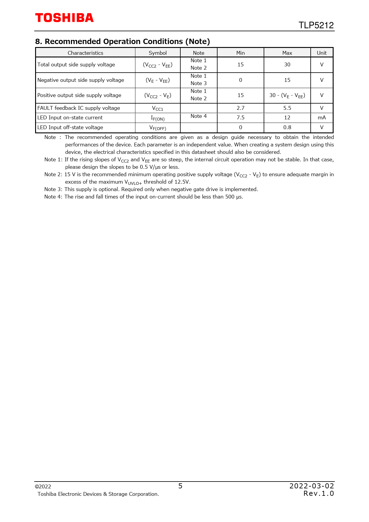

8. Recommended Operation Conditions (Note)
8 Recommended Operation Conditions (Note)
TLP5212
Characteristics Symbol Note Min Max Unit Note 1 Total output side supply voltage (VCC2 - VEE) Note 2 15 30 V Note 1 Negative output side supply voltage (VE - VEE) Note 3 0 15 V Note 1 Positive output side supply voltage (VCC2 - VE) Note 2 15 30 - (VE - VEE) V FAULT feedback IC supply voltage VCC1 2.7 5.5 V LED Input on-state current IF(ON) Note 4 7.5 12 mA LED Input off-state voltage VF(OFF) 0 0.8 V Note : The recommended operating conditions are given as a design guide necessary to obtain the intended performances of the device. Each parameter is an independent value. When creating a system design using this device, the electrical characteristics specified in this datasheet should also be considered. Note 1: If the rising slopes of VCC2 and VEE are so steep, the internal circuit operation may not be stable. In that case, please design the slopes to be 0.5 V/μs or less. Note 2: 15 V is the recommended minimum operating positive supply voltage (VCC2 - VE) to ensure adequate margin in excess of the maximum VUVLO+ threshold of 12.5V. Note 3: This supply is optional. Required only when negative gate drive is implemented. Note 4: The rise and fal times of the input on-current should be less than 500 μs. ©2022 5 2022-03-02 Toshiba Electronic Devices & Storage Corporation. Rev.1.0
