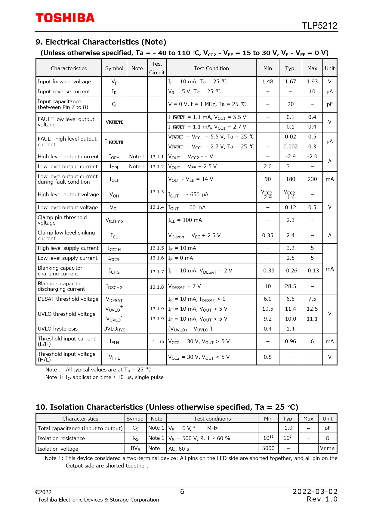

9. Electrical Characteristics (Note)
9 Electrical Characteristics (Note)
TLP5212
9. Electrical Characteristics (Note) (Unless otherwise specified, Ta = - 40 to 110 °C, VCC2 - VEE = 15 to 30 V, VE - VEE = 0 V)
Test Characteristics Symbol Note Test Condition Min Typ. Max Unit Circuit Input forward voltage VF IF = 10 mA, Ta = 25 ℃ 1.48 1.67 1.93 V Input reverse current IR VR = 5 V, Ta = 25 ℃ - - 10 μA Input capacitance (between Pin 7 to 8) Ct V = 0 V, f = 1 MHz, Ta = 25 ℃ - 20 - pF FAULT low level output I 𝐅𝐅𝐅𝐅 ��� 𝐅𝐅 �� 𝐅𝐅 �� 𝐅𝐅 ��� = 1.1 mA, VCC1 = 5.5 V - 0.1 0.4 voltage V𝐅𝐅𝐅𝐅 ��� 𝐅𝐅 �� 𝐅𝐅 ��𝐅𝐅 ��𝐅𝐅�� V I 𝐅𝐅𝐅𝐅 ��� 𝐅𝐅 �� 𝐅𝐅 �� 𝐅𝐅 ��� = 1.1 mA, VCC1 = 2.7 V - 0.1 0.4 FAULT high level output V𝐅𝐅𝐅𝐅 ��� 𝐅𝐅 �� 𝐅𝐅 �� 𝐅𝐅 ��� = VCC1 = 5.5 V, Ta = 25 ℃ - 0.02 0.5 current I 𝐅𝐅𝐅𝐅 ��� 𝐅𝐅 �� 𝐅𝐅 �� 𝐅𝐅 �� 𝐅𝐅 ��� μA V𝐅𝐅𝐅𝐅 ��� 𝐅𝐅 �� 𝐅𝐅 �� 𝐅𝐅 ��� = VCC1 = 2.7 V, Ta = 25 ℃ - 0.002 0.3 High level output current IOPH Note 1 13.1.1 VOUT = VCC2 - 4 V - -2.9 -2.0 A Low level output current IOPL Note 1 13.1.2 VOUT = VEE + 2.5 V 2.0 3.1 - Low level output current during fault condition IOLF VOUT - VEE = 14 V 90 180 230 mA High level output voltage V V OH 13.1.3 IOUT = - 650 μA VCC2- CC2- 2.9 1.6 - Low level output voltage VOL 13.1.4 IOUT = 100 mA - 0.12 0.5 V Clamp pin threshold voltage VtClamp ICL = 100 mA - 2.3 - Clamp low level sinking current ICL VClamp = VEE + 2.5 V 0.35 2.4 - A High level supply current ICC2H 13.1.5 IF = 10 mA - 3.2 5 Low level supply current ICC2L 13.1.6 IF = 0 mA - 2.5 5 Blanking capacitor mA charging current ICHG 13.1.7 IF = 10 mA, VDESAT = 2 V -0.33 -0.26 -0.13 Blanking capacitor discharging current IDSCHG 13.1.8 VDESAT = 7 V 10 28.5 - DESAT threshold voltage VDESAT IF = 10 mA, IDESAT > 0 6.0 6.6 7.5 V + UVLO 13.1.9 IF = 10 mA, VOUT > 5 V 10.5 11.4 12.5 UVLO threshold voltage V V - UVLO 13.1.9 IF = 10 mA, VOUT < 5 V 9.2 10.0 11.1 UVLO hysteresis UVLOHYS (VUVLO+ - VUVLO-) 0.4 1.4 - Threshold input current (L/H) IFLH 13.1.10 VCC2 = 30 V, VOUT > 5 V - 0.96 6 mA Threshold input voltage (H/L) VFHL VCC2 = 30 V, VOUT < 5 V 0.8 - - V Note : All typical values are at Ta = 25 ℃. Note 1: IO application time ≤ 10 μs, single pulse
10. Isolation Characteristics (Unless otherwise specified, Ta = 25 °C)
Characteristics Symbol Note Test conditions Min Typ. Max Unit Total capacitance (input to output) CS Note 1 VS = 0 V, f = 1 MHz - 1.0 - pF Isolation resistance RS Note 1 VS = 500 V, R.H. ≤ 60 % 1012 1014 - Ω Isolation voltage BVS Note 1 AC, 60 s 5000 - - Vrms Note 1: This device considered a two-terminal device: All pins on the LED side are shorted together, and al pin on the Output side are shorted together. ©2022 6 2022-03-02 Toshiba Electronic Devices & Storage Corporation. Rev.1.0
