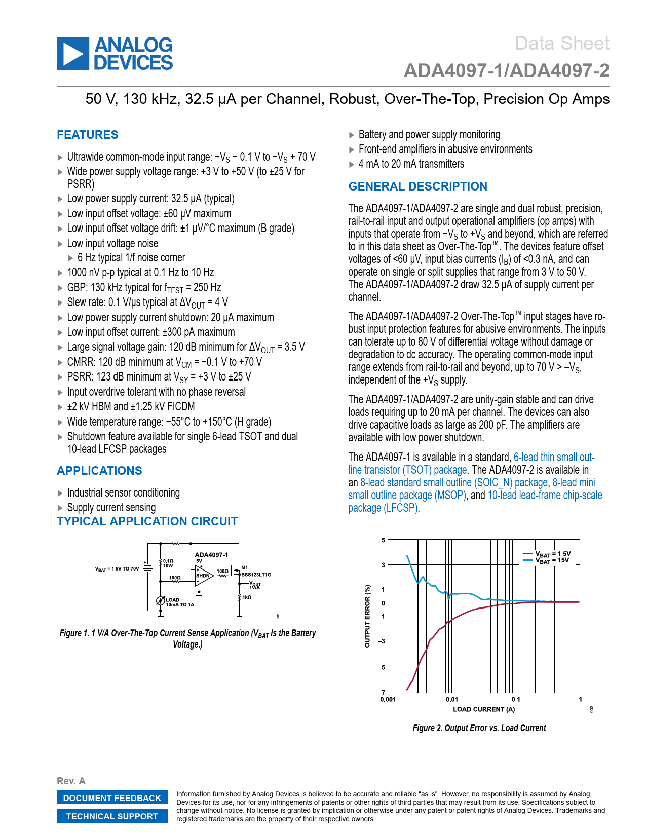

50 V, 130 kHz, 32.5 µA per Channel, Robust, Over-The-Top, Precision Op Amps
FEATURES
► Battery and power supply monitoring ► Front-end amplifiers in abusive environments ► Ultrawide common-mode input range: −VS − 0.1 V to −VS + 70 V ► 4 mA to 20 mA transmitters ► Wide power supply voltage range: +3 V to +50 V (to ±25 V for PSRR)
GENERAL DESCRIPTION
► Low power supply current: 32.5 µA (typical) The ADA4097-1/ADA4097-2 are single and dual robust, precision, ► Low input offset voltage: ±60 µV maximum rail-to-rail input and output operational amplifiers (op amps) with ► Low input offset voltage drift: ±1 µV/°C maximum (B grade) inputs that operate from −VS to +VS and beyond, which are referred ► Low input voltage noise to in this data sheet as Over-The-Top™. The devices feature offset ► 6 Hz typical 1/f noise corner voltages of <60 µV, input bias currents (IB) of <0.3 nA, and can ► 1000 nV p-p typical at 0.1 Hz to 10 Hz operate on single or split supplies that range from 3 V to 50 V. ► GBP: 130 kHz typical for f The ADA4097-1/ADA4097-2 draw 32.5 µA of supply current per TEST = 250 Hz channel. ► Slew rate: 0.1 V/µs typical at ΔVOUT = 4 V ► Low power supply current shutdown: 20 µA maximum The ADA4097-1/ADA4097-2 Over-The-Top™ input stages have ro- ► Low input offset current: ±300 pA maximum bust input protection features for abusive environments. The inputs can tolerate up to 80 V of differential voltage without damage or ► Large signal voltage gain: 120 dB minimum for ΔVOUT = 3.5 V degradation to dc accuracy. The operating common-mode input ► CMRR: 120 dB minimum at VCM = −0.1 V to +70 V range extends from rail-to-rail and beyond, up to 70 V > –VS, ► PSRR: 123 dB minimum at VSY = +3 V to ±25 V independent of the +VS supply. ► Input overdrive tolerant with no phase reversal The ADA4097-1/ADA4097-2 are unity-gain stable and can drive ► ±2 kV HBM and ±1.25 kV FICDM loads requiring up to 20 mA per channel. The devices can also ► Wide temperature range: −55°C to +150°C (H grade) drive capacitive loads as large as 200 pF. The amplifiers are ► Shutdown feature available for single 6-lead TSOT and dual available with low power shutdown. 10-lead LFCSP packages The ADA4097-1 is available in a standard, 6-lead thin small out-
APPLICATIONS
line transistor (TSOT) package. The ADA4097-2 is available in an 8-lead standard small outline (SOIC_N) package, 8-lead mini ► Industrial sensor conditioning small outline package (MSOP), and 10-lead lead-frame chip-scale ► Supply current sensing package (LFCSP).
TYPICAL APPLICATION CIRCUIT Figure 1. 1 V/A Over-The-Top Current Sense Application (VBAT Is the Battery Voltage.) Figure 2. Output Error vs. Load Current Rev. A DOCUMENT FEEDBACK
