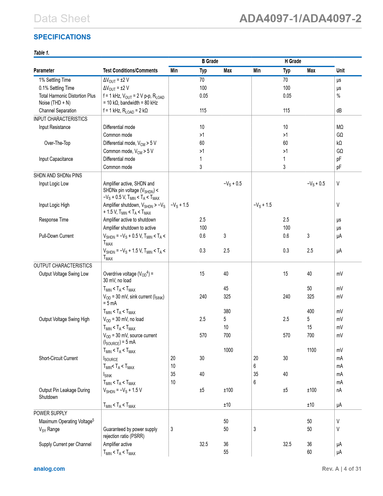

ADA4097-1/ADA4097-2. SPECIFICATIONS. Table 1. B Grade. H Grade. Parameter. Test Conditions/Comments. Min. Typ. Max. Unit. analog.com
ADA4097-1/ADA4097-2 SPECIFICATIONS Table 1 B Grade H Grade Parameter Test Conditions/Comments Min Typ Max Unit analog.com
link to page 5 link to page 5 Data Sheet
ADA4097-1/ADA4097-2 SPECIFICATIONS Table 1. B Grade H Grade Parameter Test Conditions/Comments Min Typ Max Min Typ Max Unit
1% Settling Time ΔVOUT = ±2 V 70 70 µs 0.1% Settling Time ΔVOUT = ±2 V 100 100 µs Total Harmonic Distortion Plus f = 1 kHz, VOUT = 2 V p-p, RLOAD 0.05 0.05 % Noise (THD + N) = 10 kΩ, bandwidth = 80 kHz Channel Separation f = 1 kHz, RLOAD = 2 kΩ 115 115 dB INPUT CHARACTERISTICS Input Resistance Differential mode 10 10 MΩ Common mode >1 >1 GΩ Over-The-Top Differential mode, VCM > 5 V 60 60 kΩ Common mode, VCM > 5 V >1 >1 GΩ Input Capacitance Differential mode 1 1 pF Common mode 3 3 pF SHDN AND SHDNx PINS Input Logic Low Amplifier active, SHDN and −VS + 0.5 −VS + 0.5 V SHDNx pin voltage (VSHDN) < −VS + 0.5 V, TMIN < TA < TMAX Input Logic High Amplifier shutdown, VSHDN > −VS −VS + 1.5 −VS + 1.5 V + 1.5 V, TMIN < TA < TMAX Response Time Amplifier active to shutdown 2.5 2.5 µs Amplifier shutdown to active 100 100 µs Pull-Down Current VSHDN = −VS + 0.5 V, TMIN < TA < 0.6 3 0.6 3 µA TMAX VSHDN = −VS + 1.5 V, TMIN < TA < 0.3 2.5 0.3 2.5 µA TMAX OUTPUT CHARACTERISTICS Output Voltage Swing Low Overdrive voltage (V 4 OD ) = 15 40 15 40 mV 30 mV, no load TMIN < TA < TMAX 45 50 mV VOD = 30 mV, sink current (ISINK) 240 325 240 325 mV = 5 mA TMIN < TA < TMAX 380 400 mV Output Voltage Swing High VOD = 30 mV, no load 2.5 5 2.5 5 mV TMIN < TA < TMAX 10 15 mV VOD = 30 mV, source current 570 700 570 700 mV (ISOURCE) = 5 mA TMIN < TA < TMAX 1000 1100 mV Short-Circuit Current ISOURCE 20 30 20 30 mA TMIN< TA < TMAX 10 6 mA ISINK 35 40 35 40 mA TMIN < TA < TMAX 10 6 mA Output Pin Leakage During VSHDN = −VS + 1.5 V ±5 ±100 ±5 ±100 nA Shutdown TMIN < TA < TMAX ±10 ±10 µA POWER SUPPLY Maximum Operating Voltage5 50 50 V VSY Range Guaranteed by power supply 3 50 3 50 V rejection ratio (PSRR) Supply Current per Channel Amplifier active 32.5 36 32.5 36 µA TMIN < TA < TMAX 55 60 µA
