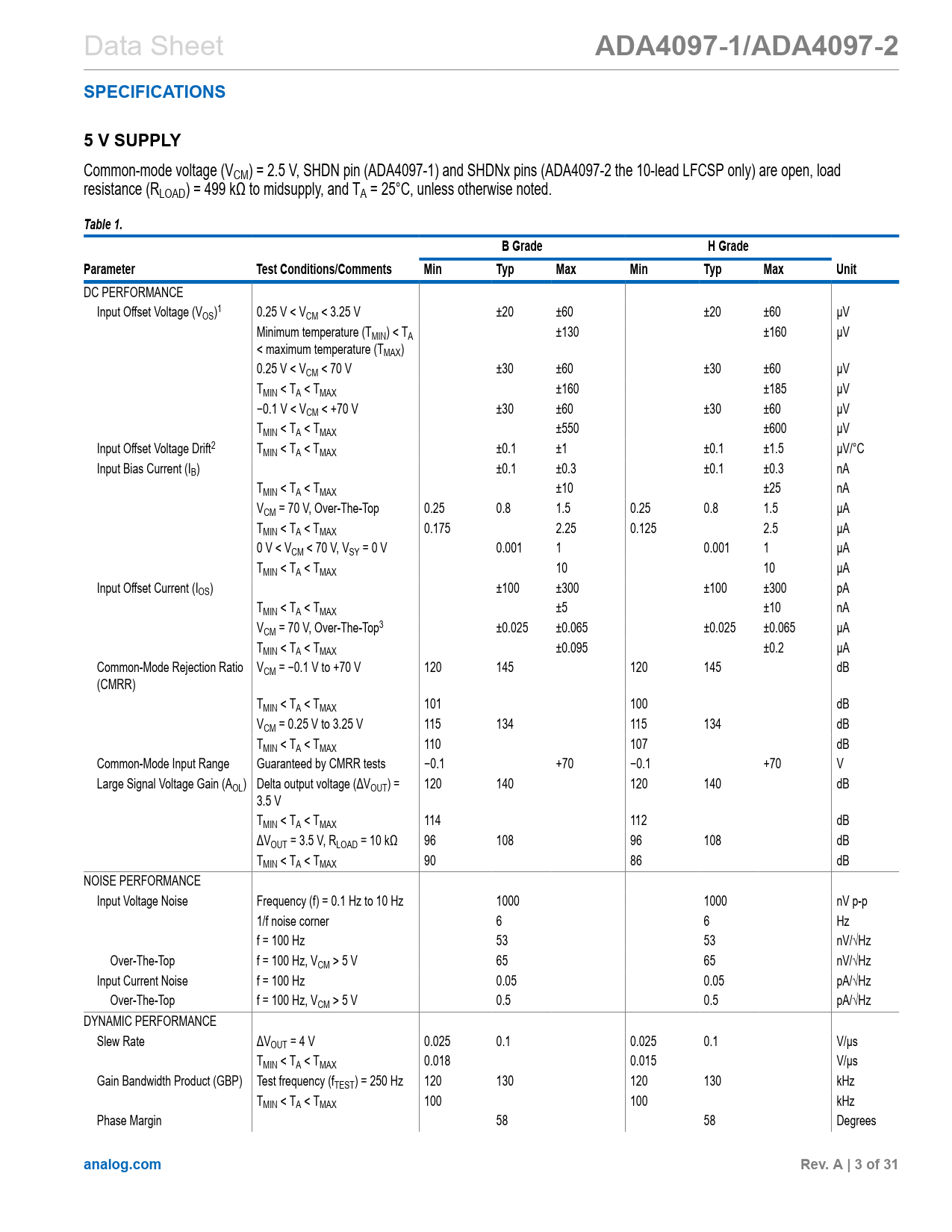

ADA4097-1/ADA4097-2. SPECIFICATIONS. 5 V SUPPLY. Table 1. B Grade. H Grade. Parameter. Test Conditions/Comments. Min. Typ. Max. Unit
ADA4097-1/ADA4097-2 SPECIFICATIONS 5 V SUPPLY Table 1 B Grade H Grade Parameter Test Conditions/Comments Min Typ Max Unit
link to page 5 link to page 5 link to page 5 Data Sheet
Common-mode voltage (VCM) = 2.5 V, SHDN pin (ADA4097-1) and SHDNx pins (ADA4097-2 the 10-lead LFCSP only) are open, load resistance (RLOAD) = 499 kΩ to midsupply, and TA = 25°C, unless otherwise noted.
Table 1. B Grade H Grade Parameter Test Conditions/Comments Min Typ Max Min Typ Max Unit
DC PERFORMANCE Input Offset Voltage (VOS)1 0.25 V < VCM < 3.25 V ±20 ±60 ±20 ±60 µV Minimum temperature (TMIN) < TA ±130 ±160 µV < maximum temperature (TMAX) 0.25 V < VCM < 70 V ±30 ±60 ±30 ±60 µV TMIN < TA < TMAX ±160 ±185 µV −0.1 V < VCM < +70 V ±30 ±60 ±30 ±60 µV TMIN < TA < TMAX ±550 ±600 µV Input Offset Voltage Drift2 TMIN < TA < TMAX ±0.1 ±1 ±0.1 ±1.5 µV/°C Input Bias Current (IB) ±0.1 ±0.3 ±0.1 ±0.3 nA TMIN < TA < TMAX ±10 ±25 nA VCM = 70 V, Over-The-Top 0.25 0.8 1.5 0.25 0.8 1.5 µA TMIN < TA < TMAX 0.175 2.25 0.125 2.5 µA 0 V < VCM < 70 V, VSY = 0 V 0.001 1 0.001 1 µA TMIN < TA < TMAX 10 10 µA Input Offset Current (IOS) ±100 ±300 ±100 ±300 pA TMIN < TA < TMAX ±5 ±10 nA VCM = 70 V, Over-The-Top3 ±0.025 ±0.065 ±0.025 ±0.065 µA TMIN < TA < TMAX ±0.095 ±0.2 µA Common-Mode Rejection Ratio VCM = −0.1 V to +70 V 120 145 120 145 dB (CMRR) TMIN < TA < TMAX 101 100 dB VCM = 0.25 V to 3.25 V 115 134 115 134 dB TMIN < TA < TMAX 110 107 dB Common-Mode Input Range Guaranteed by CMRR tests −0.1 +70 −0.1 +70 V Large Signal Voltage Gain (AOL) Delta output voltage (ΔVOUT) = 120 140 120 140 dB 3.5 V TMIN < TA < TMAX 114 112 dB ΔVOUT = 3.5 V, RLOAD = 10 kΩ 96 108 96 108 dB TMIN < TA < TMAX 90 86 dB NOISE PERFORMANCE Input Voltage Noise Frequency (f) = 0.1 Hz to 10 Hz 1000 1000 nV p-p 1/f noise corner 6 6 Hz f = 100 Hz 53 53 nV/√Hz Over-The-Top f = 100 Hz, VCM > 5 V 65 65 nV/√Hz Input Current Noise f = 100 Hz 0.05 0.05 pA/√Hz Over-The-Top f = 100 Hz, VCM > 5 V 0.5 0.5 pA/√Hz DYNAMIC PERFORMANCE Slew Rate ΔVOUT = 4 V 0.025 0.1 0.025 0.1 V/µs TMIN < TA < TMAX 0.018 0.015 V/µs Gain Bandwidth Product (GBP) Test frequency (fTEST) = 250 Hz 120 130 120 130 kHz TMIN < TA < TMAX 100 100 kHz Phase Margin 58 58 Degrees
