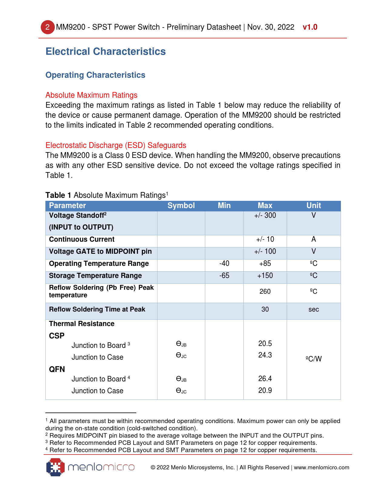

v1.0 Electrical Characteristics Operating Characteristics
Absolute Maximum Ratings Exceeding the maximum ratings as listed in Table 1 below may reduce the reliability of the device or cause permanent damage. Operation of the MM9200 should be restricted to the limits indicated in Table 2 recommended operating conditions. Electrostatic Discharge (ESD) Safeguards The MM9200 is a Class 0 ESD device. When handling the MM9200, observe precautions as with any other ESD sensitive device. Do not exceed the voltage ratings specified in Table 1.
Table 1
Absolute Maximum Ratings1
Parameter Symbol Min Max Unit Voltage Standoff2
+/- 300 V
(INPUT to OUTPUT) Continuous Current
+/- 10 A
Voltage GATE to MIDPOINT pin
+/- 100 V
Operating Temperature Range
-40 +85 ºC
Storage Temperature Range
-65 +150 ºC
Reflow Soldering (Pb Free) Peak
260 ºC
temperature Reflow Soldering Time at Peak
30 sec
Thermal Resistance CSP
Junction to Board 3 ƟJB 20.5 Junction to Case ƟJC 24.3 ºC/W
QFN
Junction to Board 4 ƟJB 26.4 Junction to Case ƟJC 20.9 1 All parameters must be within recommended operating conditions. Maximum power can only be applied during the on-state condition (cold-switched condition). 2 Requires MIDPOINT pin biased to the average voltage between the INPUT and the OUTPUT pins. 3 Refer to Recommended PCB Layout and SMT Parameters on page 12 for copper requirements. 4 Refer to Recommended PCB Layout and SMT Parameters on page 12 for copper requirements. © 2022 Menlo Microsystems, Inc. | All Rights Reserved | www.menlomicro.com
