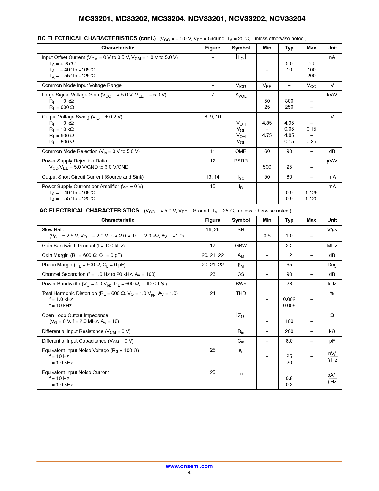

MC33201, MC33202, MC33204, NCV33201, NCV33202, NCV33204. DC ELECTRICAL CHARACTERISTICS (cont.). Characteristic. Figure. Symbol
MC33201, MC33202, MC33204, NCV33201, NCV33202, NCV33204 DC ELECTRICAL CHARACTERISTICS (cont.)
(VCC = + 5.0 V, VEE = Ground, TA = 25°C, unless otherwise noted.)
Characteristic Figure Symbol Min Typ Max Unit
Input Offset Current (VCM = 0 V to 0.5 V, VCM = 1.0 V to 5.0 V) − ⎮IIO⎮ nA TA = + 25°C − 5.0 50 TA = − 40° to +105°C − 10 100 TA = − 55° to +125°C − − 200 Common Mode Input Voltage Range − VICR VEE − VCC V Large Signal Voltage Gain (VCC = + 5.0 V, VEE = − 5.0 V) 7 AVOL kV/V RL = 10 kW 50 300 − RL = 600 W 25 250 − Output Voltage Swing (VID = ± 0.2 V) 8, 9, 10 V RL = 10 kW VOH 4.85 4.95 − RL = 10 kW VOL − 0.05 0.15 RL = 600 W VOH 4.75 4.85 − RL = 600 W VOL − 0.15 0.25 Common Mode Rejection (Vin = 0 V to 5.0 V) 11 CMR 60 90 − dB Power Supply Rejection Ratio 12 PSRR mV/V VCC/VEE = 5.0 V/GND to 3.0 V/GND 500 25 − Output Short Circuit Current (Source and Sink) 13, 14 ISC 50 80 − mA Power Supply Current per Amplifier (VO = 0 V) 15 ID mA TA = − 40° to +105°C − 0.9 1.125 TA = − 55° to +125°C − 0.9 1.125
AC ELECTRICAL CHARACTERISTICS
Slew Rate 16, 26 SR V/ms (VS = ± 2.5 V, VO = − 2.0 V to + 2.0 V, RL = 2.0 kW, AV = +1.0) 0.5 1.0 − Gain Bandwidth Product (f = 100 kHz) 17 GBW − 2.2 − MHz Gain Margin (RL = 600 W, CL = 0 pF) 20, 21, 22 AM − 12 − dB Phase Margin (RL = 600 W, CL = 0 pF) 20, 21, 22 OM − 65 − Deg Channel Separation (f = 1.0 Hz to 20 kHz, AV = 100) 23 CS − 90 − dB Power Bandwidth (VO = 4.0 Vpp, RL = 600 W, THD ≤ 1 %) BWP − 28 − kHz Total Harmonic Distortion (RL = 600 W, VO = 1.0 Vpp, AV = 1.0) 24 THD % f = 1.0 kHz − 0.002 − f = 10 kHz − 0.008 − Open Loop Output Impedance ⎮ZO⎮ W (VO = 0 V, f = 2.0 MHz, AV = 10) − 100 − Differential Input Resistance (VCM = 0 V) Rin − 200 − kW Differential Input Capacitance (VCM = 0 V) Cin − 8.0 − pF Equivalent Input Noise Voltage (RS = 100 W) 25 en f = 10 Hz − 25 − nV/ f = 1.0 kHz − 20 − Hz Equivalent Input Noise Current 25 in pA/ f = 10 Hz − 0.8 − f = 1.0 kHz − 0.2 − Hz
