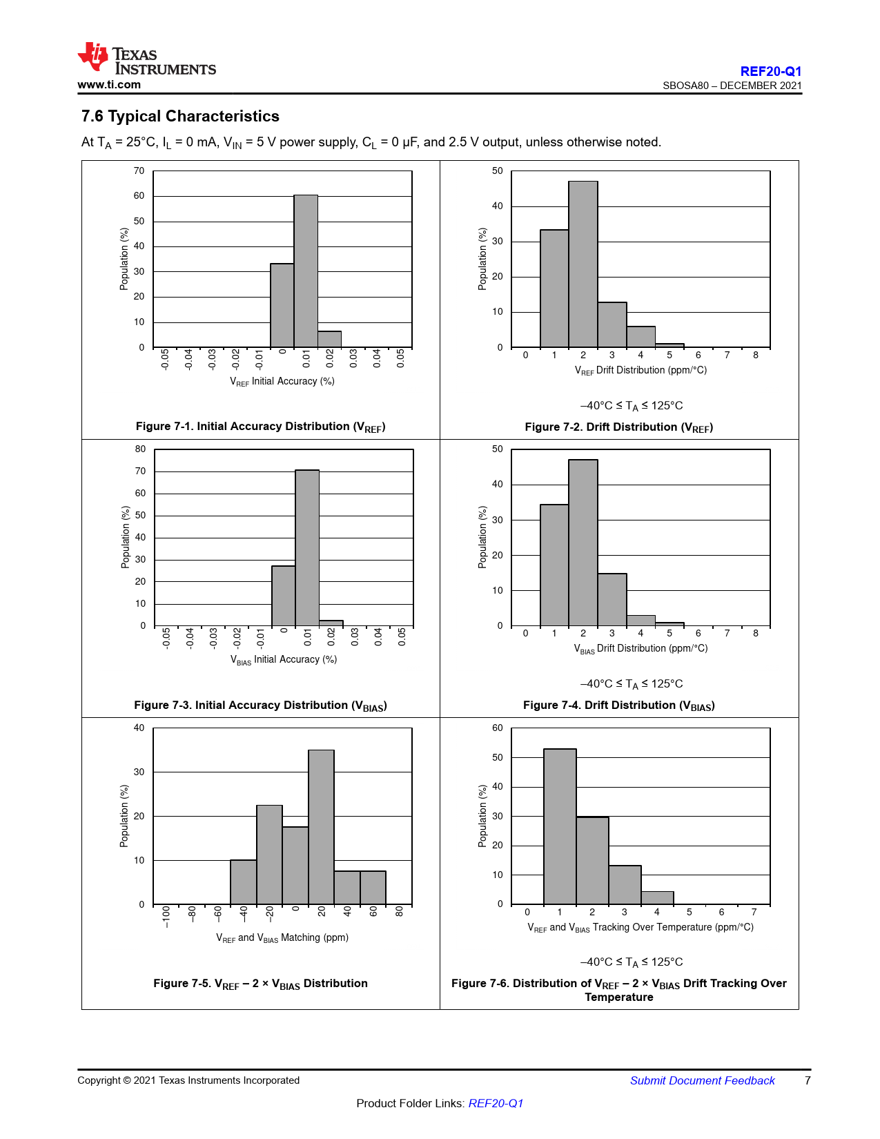

REF20-Q1. www.ti.com. 7.6 Typical Characteristics. Figure 7-1. Initial Accuracy Distribution (VREF)
REF20-Q1 www.ti.com 7.6 Typical Characteristics Figure 7-1 Initial Accuracy Distribution (VREF)
REF20-Q1 www.ti.com
SBOSA80 – DECEMBER 2021
At TA = 25°C, IL = 0 mA, VIN = 5 V power supply, CL = 0 µF, and 2.5 V output, unless otherwise noted. 70 50 60 40 50 (%) (%) 30 n 40 n tio tio la la u 30 u p p o 20 o P P 20 10 10 0 5 4 3 2 1 0 1 2 3 4 5 0 .0 .0 .0 .0 .0 .0 .0 .0 .0 .0 0 1 2 3 4 5 6 7 8 -0 -0 -0 -0 -0 0 0 0 0 0 VREF Drift Distribution (ppm/ƒC) V Initial Accuracy (%) REF C010 C015 –40°C ≤ TA ≤ 125°C
Figure 7-1. Initial Accuracy Distribution (VREF) Figure 7-2. Drift Distribution (VREF)
80 50 70 40 60 50 (%) (%) 30 n n tio 40 tio la la u u p p o 30 20 o P P 20 10 10 0 5 4 3 2 1 0 1 2 3 4 5 0 .0 .0 .0 .0 .0 .0 .0 .0 .0 .0 0 1 2 3 4 5 6 7 8 -0 -0 -0 -0 -0 0 0 0 0 0 VBIAS Drift Distribution (ppm/ƒC) V Initial Accuracy (%) BIAS C008 C015 –40°C ≤ TA ≤ 125°C
Figure 7-3. Initial Accuracy Distribution (VBIAS) Figure 7-4. Drift Distribution (VBIAS)
40 60 50 30 40 (%) (%) n n tio 20 tio 30 la la u u p p o o P P 20 10 10 0 0 0 0 0 0 0 0 0 0 0 0 0 8 6 4 2 2 4 6 8 0 1 2 3 4 5 6 7 1 ± ± ± ± ± VREF and VBIAS Tracking Over Temperature (ppm/ƒC) V and V Matching (ppm) REF BIAS C004 C017 –40°C ≤ TA ≤ 125°C
Figure 7-5. VREF – 2 × VBIAS Distribution Figure 7-6. Distribution of VREF – 2 × VBIAS Drift Tracking Over Temperature
