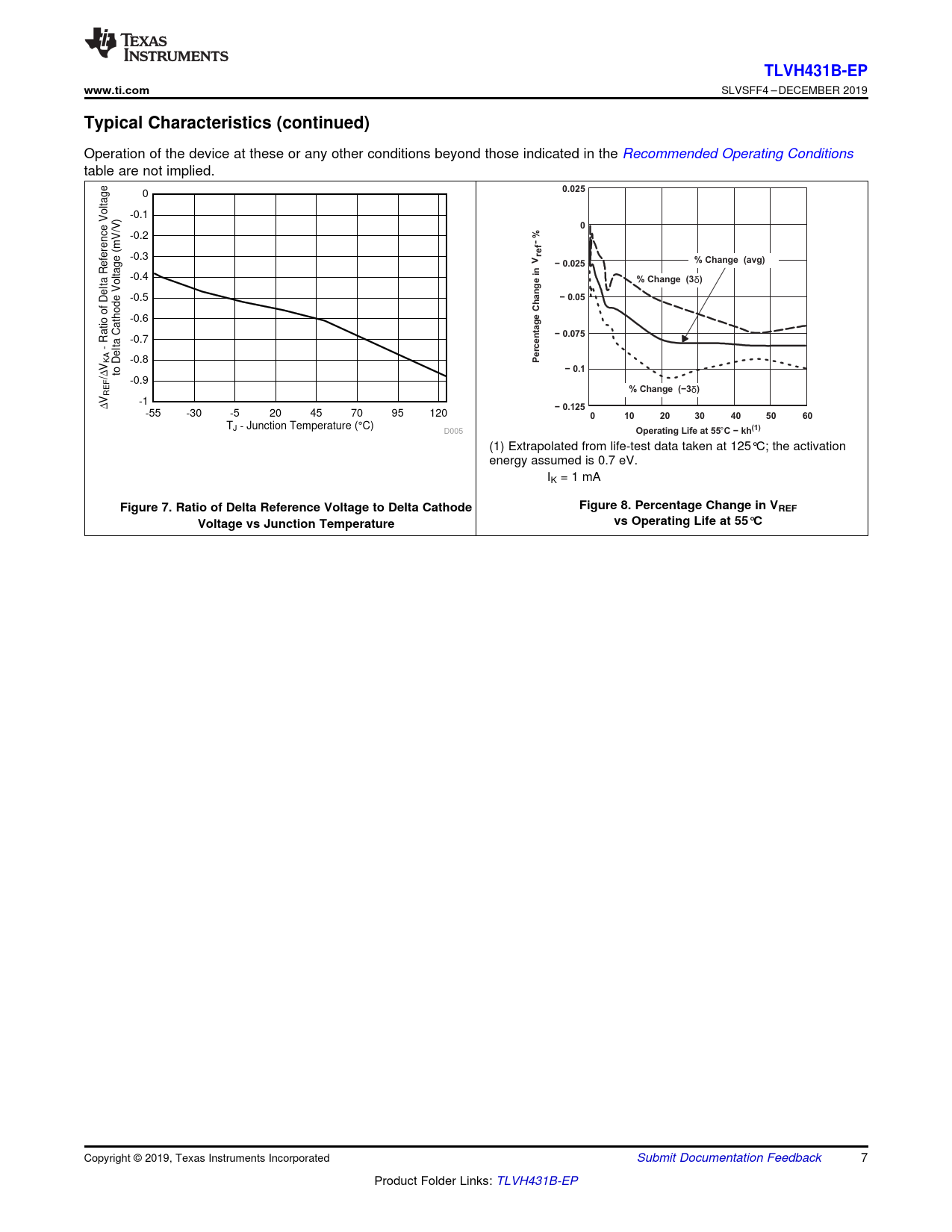

Pages / Page29 / 7 — TLVH431B-EP. www.ti.com. Typical Characteristics (continued). 0.025. % −. …
TLVH431B-EP. www.ti.com. Typical Characteristics (continued). 0.025. % −. re refV. − 0.025. % Change (avg). n V. e i. % Change (3. − 0.05. e C
TLVH431B-EP www.ti.com Typical Characteristics (continued) 0.025 % − re refV − 0.025 % Change (avg) n V e i % Change (3 − 0.05 e C
Operation of the device at these or any other conditions beyond those indicated in the Recommended Operating Conditions table are not implied. e

Operating Life at 55
C − kh(1)
(1) Extrapolated from life-test data taken at 125°C; the activation energy assumed is 0.7 eV. IK = 1 mA
Figure 7. Ratio of Delta Reference Voltage to Delta Cathode Figure 8. Percentage Change in VREF Voltage vs Junction Temperature vs Operating Life at 55°C
