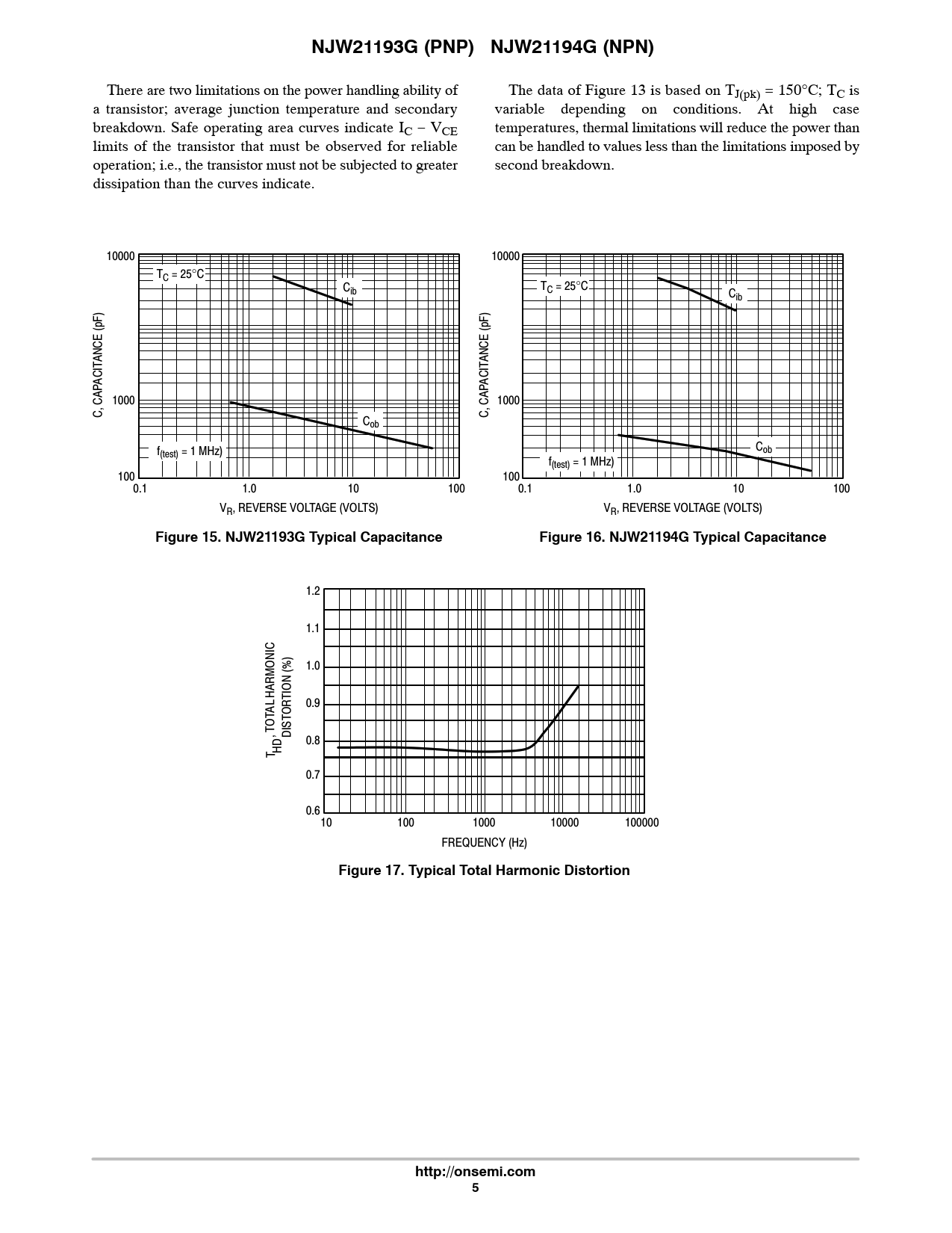

NJW21193G (PNP) NJW21194G (NPN). Figure 15. NJW21193G Typical Capacitance. Figure 16. NJW21194G Typical Capacitance
NJW21193G (PNP) NJW21194G (NPN) Figure 15 NJW21193G Typical Capacitance Figure 16 NJW21194G Typical Capacitance
link to page 5
There are two limitations on the power handling ability of The data of Figure 13 is based on TJ(pk) = 150°C; TC is a transistor; average junction temperature and secondary variable depending on conditions. At high case breakdown. Safe operating area curves indicate IC − VCE temperatures, thermal limitations will reduce the power than limits of the transistor that must be observed for reliable can be handled to values less than the limitations imposed by operation; i.e., the transistor must not be subjected to greater second breakdown. dissipation than the curves indicate. 10000 10000 TC = 25°C C T ib C = 25°C Cib ANCE (pF) ANCE (pF) ACIT ACIT 1000 1000 C, CAP C, CAP Cob Cob f(test) = 1 MHz) f(test) = 1 MHz) 100 100 0.1 1.0 10 100 0.1 1.0 10 100 VR, REVERSE VOLTAGE (VOLTS) VR, REVERSE VOLTAGE (VOLTS)
Figure 15. NJW21193G Typical Capacitance Figure 16. NJW21194G Typical Capacitance
1.2 1.1 1.0 TION (%) L HARMONIC 0.9 TA OR O , T DIST 0.8 T HD 0.7 0.6 10 100 1000 10000 100000 FREQUENCY (Hz)
Figure 17. Typical Total Harmonic Distortion http://onsemi.com 5
