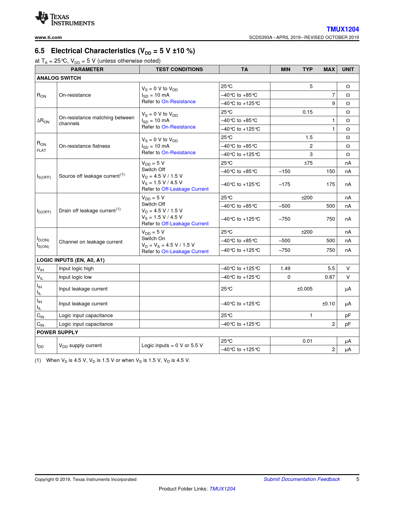

TMUX1204. www.ti.com. 6.5 Electrical Characteristics (VDD = 5 V ±10 %). PARAMETER. TEST CONDITIONS. MIN. TYP. MAX. UNIT. ANALOG SWITCH
TMUX1204 www.ti.com 6.5 Electrical Characteristics (VDD = 5 V ±10 %) PARAMETER TEST CONDITIONS MIN TYP MAX UNIT ANALOG SWITCH
link to page 14 link to page 14 link to page 14 link to page 14 link to page 14 link to page 15
TMUX1204 www.ti.com
SCDS393A – APRIL 2019 – REVISED OCTOBER 2019
at TA = 25°C, VDD = 5 V (unless otherwise noted)
PARAMETER TEST CONDITIONS TA MIN TYP MAX UNIT ANALOG SWITCH
V 25°C 5 Ω S = 0 V to VDD RON On-resistance ISD = 10 mA –40°C to +85°C 7 Ω Refer to On-Resistance –40°C to +125°C 9 Ω V 25°C 0.15 Ω On-resistance matching between S = 0 V to VDD ΔRON I –40°C to +85°C 1 Ω channels SD = 10 mA Refer to On-Resistance –40°C to +125°C 1 Ω V 25°C 1.5 Ω R S = 0 V to VDD ON On-resistance flatness ISD = 10 mA –40°C to +85°C 2 Ω FLAT Refer to On-Resistance –40°C to +125°C 3 Ω VDD = 5 V 25°C ±75 nA Switch Off –40°C to +85°C –150 150 nA IS(OFF) Source off leakage current(1) VD = 4.5 V / 1.5 V VS = 1.5 V / 4.5 V –40°C to +125°C –175 175 nA Refer to Off-Leakage Current VDD = 5 V 25°C ±200 nA Switch Off –40°C to +85°C –500 500 nA ID(OFF) Drain off leakage current(1) VD = 4.5 V / 1.5 V VS = 1.5 V / 4.5 V –40°C to +125°C –750 750 nA Refer to Off-Leakage Current VDD = 5 V 25°C ±200 nA ID(ON) Switch On Channel on leakage current –40°C to +85°C –500 500 nA IS(ON) VD = VS = 4.5 V / 1.5 V Refer to On-Leakage Current –40°C to +125°C –750 750 nA
LOGIC INPUTS (EN, A0, A1)
VIH Input logic high –40°C to +125°C 1.49 5.5 V VIL Input logic low –40°C to +125°C 0 0.87 V IIH Input leakage current 25°C ±0.005 µA IIL IIH Input leakage current –40°C to +125°C ±0.10 µA IIL CIN Logic input capacitance 25°C 1 pF CIN Logic input capacitance –40°C to +125°C 2 pF
POWER SUPPLY
25°C 0.01 µA IDD VDD supply current Logic inputs = 0 V or 5.5 V –40°C to +125°C 2 µA (1) When VS is 4.5 V, VD is 1.5 V or when VS is 1.5 V, VD is 4.5 V. Copyright © 2019, Texas Instruments Incorporated Submit Documentation Feedback 5 Product Folder Links: TMUX1204 Document Outline 1 Features 2 Applications 3 Description Table of Contents 4 Revision History 5 Pin Configuration and Functions 6 Specifications 6.1 Absolute Maximum Ratings 6.2 ESD Ratings 6.3 Recommended Operating Conditions 6.4 Thermal Information 6.5 Electrical Characteristics (VDD = 5 V ±10 %) 6.6 Electrical Characteristics (VDD = 3.3 V ±10 %) 6.7 Electrical Characteristics (VDD = 1.8 V ±10 %) 6.8 Electrical Characteristics (VDD = 1.2 V ±10 %) 6.9 Typical Characteristics 7 Parameter Measurement Information 7.1 On-Resistance 7.2 Off-Leakage Current 7.3 On-Leakage Current 7.4 Transition Time 7.5 Break-Before-Make 7.6 tON(EN) and tOFF(EN) 7.7 Charge Injection 7.8 Off Isolation 7.9 Crosstalk 7.10 Bandwidth 8 Detailed Description 8.1 Functional Block Diagram 8.2 Feature Description 8.2.1 Bidirectional Operation 8.2.2 Rail to Rail Operation 8.2.3 1.8 V Logic Compatible Inputs 8.2.4 Fail-Safe Logic 8.3 Device Functional Modes 8.4 Truth Tables 9 Application and Implementation 9.1 Application Information 9.2 Typical Application 9.3 Design Requirements 9.4 Detailed Design Procedure 9.5 Application Curve 10 Power Supply Recommendations 11 Layout 11.1 Layout Guidelines 11.1.1 Layout Information 11.2 Layout Example 12 Device and Documentation Support 12.1 Documentation Support 12.1.1 Related Documentation 12.2 Receiving Notification of Documentation Updates 12.3 Community Resources 12.4 Trademarks 12.5 Electrostatic Discharge Caution 12.6 Glossary 13 Mechanical, Packaging, and Orderable Information
