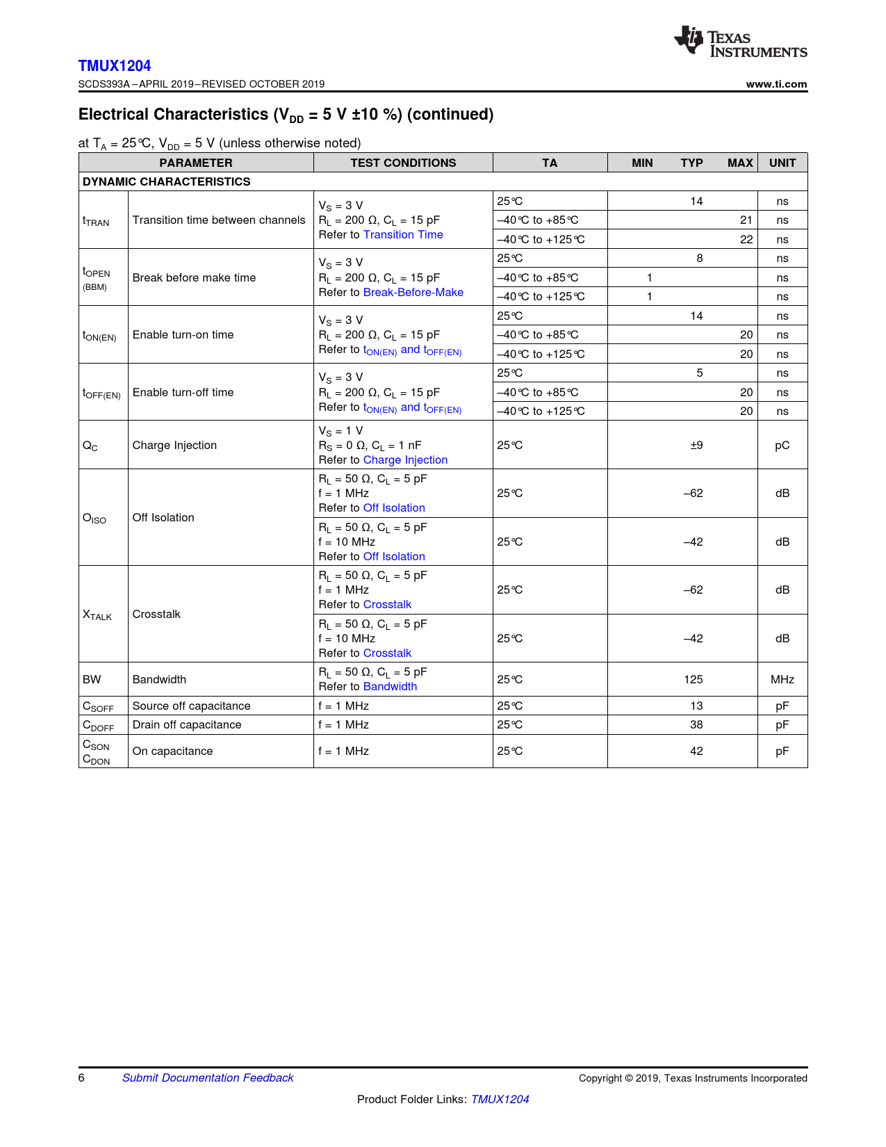

PARAMETER TEST CONDITIONS TA MIN TYP MAX UNIT DYNAMIC CHARACTERISTICS
V 25°C 14 ns S = 3 V tTRAN Transition time between channels RL = 200 Ω, CL = 15 pF –40°C to +85°C 21 ns Refer to Transition Time –40°C to +125°C 22 ns V 25°C 8 ns t S = 3 V OPEN Break before make time RL = 200 Ω, CL = 15 pF –40°C to +85°C 1 ns (BBM) Refer to Break-Before-Make –40°C to +125°C 1 ns V 25°C 14 ns S = 3 V tON(EN) Enable turn-on time RL = 200 Ω, CL = 15 pF –40°C to +85°C 20 ns Refer to tON(EN) and tOFF(EN) –40°C to +125°C 20 ns V 25°C 5 ns S = 3 V tOFF(EN) Enable turn-off time RL = 200 Ω, CL = 15 pF –40°C to +85°C 20 ns Refer to tON(EN) and tOFF(EN) –40°C to +125°C 20 ns VS = 1 V QC Charge Injection RS = 0 Ω, CL = 1 nF 25°C ±9 pC Refer to Charge Injection RL = 50 Ω, CL = 5 pF f = 1 MHz 25°C –62 dB Refer to Off Isolation OISO Off Isolation RL = 50 Ω, CL = 5 pF f = 10 MHz 25°C –42 dB Refer to Off Isolation RL = 50 Ω, CL = 5 pF f = 1 MHz 25°C –62 dB Refer to Crosstalk XTALK Crosstalk RL = 50 Ω, CL = 5 pF f = 10 MHz 25°C –42 dB Refer to Crosstalk R BW Bandwidth L = 50 Ω, CL = 5 pF 25°C 125 MHz Refer to Bandwidth CSOFF Source off capacitance f = 1 MHz 25°C 13 pF CDOFF Drain off capacitance f = 1 MHz 25°C 38 pF CSON On capacitance f = 1 MHz 25°C 42 pF CDON 6 Submit Documentation Feedback Copyright © 2019, Texas Instruments Incorporated Product Folder Links: TMUX1204 Document Outline 1 Features 2 Applications 3 Description Table of Contents 4 Revision History 5 Pin Configuration and Functions 6 Specifications 6.1 Absolute Maximum Ratings 6.2 ESD Ratings 6.3 Recommended Operating Conditions 6.4 Thermal Information 6.5 Electrical Characteristics (VDD = 5 V ±10 %) 6.6 Electrical Characteristics (VDD = 3.3 V ±10 %) 6.7 Electrical Characteristics (VDD = 1.8 V ±10 %) 6.8 Electrical Characteristics (VDD = 1.2 V ±10 %) 6.9 Typical Characteristics 7 Parameter Measurement Information 7.1 On-Resistance 7.2 Off-Leakage Current 7.3 On-Leakage Current 7.4 Transition Time 7.5 Break-Before-Make 7.6 tON(EN) and tOFF(EN) 7.7 Charge Injection 7.8 Off Isolation 7.9 Crosstalk 7.10 Bandwidth 8 Detailed Description 8.1 Functional Block Diagram 8.2 Feature Description 8.2.1 Bidirectional Operation 8.2.2 Rail to Rail Operation 8.2.3 1.8 V Logic Compatible Inputs 8.2.4 Fail-Safe Logic 8.3 Device Functional Modes 8.4 Truth Tables 9 Application and Implementation 9.1 Application Information 9.2 Typical Application 9.3 Design Requirements 9.4 Detailed Design Procedure 9.5 Application Curve 10 Power Supply Recommendations 11 Layout 11.1 Layout Guidelines 11.1.1 Layout Information 11.2 Layout Example 12 Device and Documentation Support 12.1 Documentation Support 12.1.1 Related Documentation 12.2 Receiving Notification of Documentation Updates 12.3 Community Resources 12.4 Trademarks 12.5 Electrostatic Discharge Caution 12.6 Glossary 13 Mechanical, Packaging, and Orderable Information
