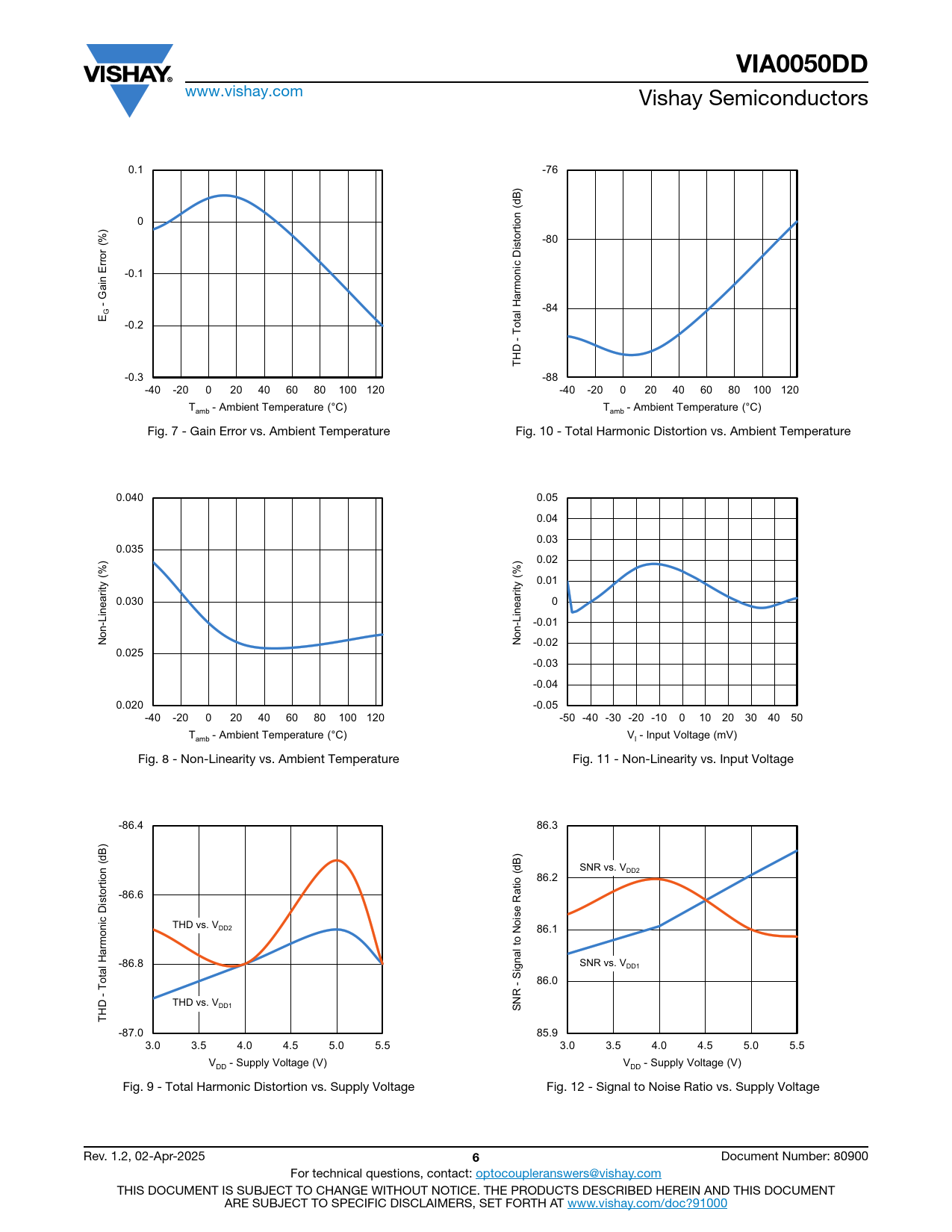

www.vishay.com Vishay Semiconductors Axis Title Axis Title 0.1 10000 -76 10000 ) (dB n 0 o ) 1000 (% torti -80 1000 is D rror ne ne ine c ne ne E -0.1 ine n oni 1st li 2nd li 2nd l 1st li rm 2nd li Gai 2nd l a - 100 H -84 100 GE tal -0.2 o - T D H T -0.3 10 -88 10 -40 -20 0 20 40 60 80 100 120 -40 -20 0 20 40 60 80 100 120 T - Ambient Temperature (°C) T - Ambient Temperature (°C) amb amb Fig. 7 - Gain Error vs. Ambient Temperature Fig. 10 - Total Harmonic Distortion vs. Ambient Temperature Axis Title Axis Title 0.040 10000 0.05 10000 0.04 0.03 0.035 ) 0.02 1000 1000 (% (% 0.01 ty ty ne ne ine ne ne ine 0.030 0 neari 1st li neari 2nd l 2nd li 1st li 2nd l 2nd li -0.01 n-Li 100 o 100 Non-Li N -0.02 0.025 -0.03 -0.04 0.020 10 -0.05 10 -40 -20 0 20 40 60 80 100 120 -50 -40 -30 -20 -10 0 10 20 30 40 50 T - Ambient Temperature (°C) V - Input Voltage (mV) amb I Fig. 8 - Non-Linearity vs. Ambient Temperature Fig. 11 - Non-Linearity vs. Input Voltage Axis Title Axis Title -86.4 10000 86.3 10000 ) (dB B) n d SNR vs. VDD2 o 86.2 torti -86.6 1000 1000 is Ratio ( D c ne ne ise ne ine THD vs. V ne ine oni DD2 86.1 No 1st li rm 2nd li 1st li 2nd l 2nd li a 2nd l l to a H -86.8 100 n SNR vs. VDD1 100 tal o - Sig 86.0 - T D THD vs. VDD1 H SNR T -87.0 10 85.9 10 3.0 3.5 4.0 4.5 5.0 5.5 3.0 3.5 4.0 4.5 5.0 5.5 V - Supply Voltage (V) V - Supply Voltage (V) DD DD Fig. 9 - Total Harmonic Distortion vs. Supply Voltage Fig. 12 - Signal to Noise Ratio vs. Supply Voltage Rev. 1.2, 02-Apr-2025
