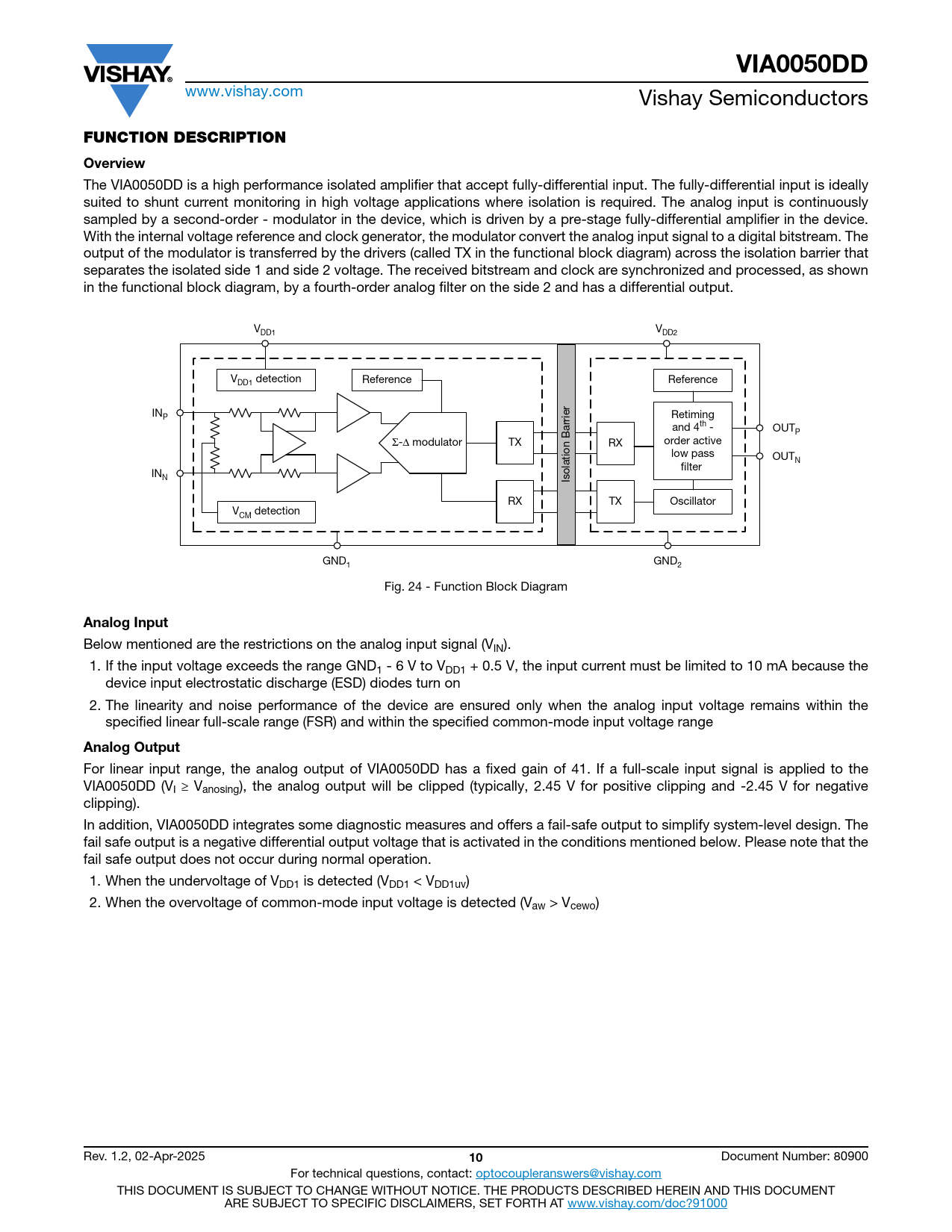

FUNCTION DESCRIPTION Overview
The VIA0050DD is a high performance isolated amplifier that accept fully-differential input. The fully-differential input is ideally suited to shunt current monitoring in high voltage applications where isolation is required. The analog input is continuously sampled by a second-order - modulator in the device, which is driven by a pre-stage fully-differential amplifier in the device. With the internal voltage reference and clock generator, the modulator convert the analog input signal to a digital bitstream. The output of the modulator is transferred by the drivers (called TX in the functional block diagram) across the isolation barrier that separates the isolated side 1 and side 2 voltage. The received bitstream and clock are synchronized and processed, as shown in the functional block diagram, by a fourth-order analog filter on the side 2 and has a differential output. V V DD1 DD2 V detection DD1 Reference Reference INP Retiming and 4th - OUTP Σ-Δ modulator TX RX order active low pass OUTN filter INN Isolation Barrier RX TX Oscillator V detection CM GND GND 1 2 Fig. 24 - Function Block Diagram
Analog Input
Below mentioned are the restrictions on the analog input signal (VIN). 1. If the input voltage exceeds the range GND1 - 6 V to VDD1 + 0.5 V, the input current must be limited to 10 mA because the device input electrostatic discharge (ESD) diodes turn on 2. The linearity and noise performance of the device are ensured only when the analog input voltage remains within the specified linear full-scale range (FSR) and within the specified common-mode input voltage range
Analog Output
For linear input range, the analog output of VIA0050DD has a fixed gain of 41. If a full-scale input signal is applied to the VIA0050DD (VI ≥ Vanosing), the analog output will be clipped (typically, 2.45 V for positive clipping and -2.45 V for negative clipping). In addition, VIA0050DD integrates some diagnostic measures and offers a fail-safe output to simplify system-level design. The fail safe output is a negative differential output voltage that is activated in the conditions mentioned below. Please note that the fail safe output does not occur during normal operation. 1. When the undervoltage of VDD1 is detected (VDD1 < VDD1uv) 2. When the overvoltage of common-mode input voltage is detected (Vaw > Vcewo) Rev. 1.2, 02-Apr-2025
