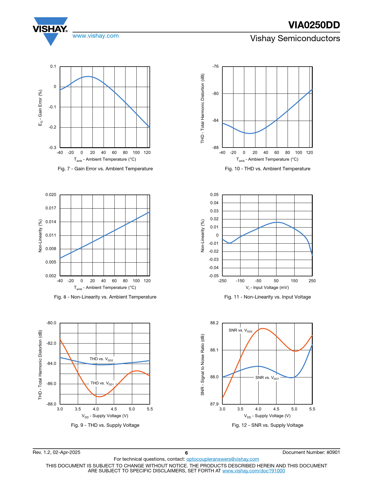

DescriptionHigh Thermal Stability Isolation Amplifier in SOP-8 (300 mil) Package
Pages / Page13 / 6 — VIA0250DD
File Format / SizePDF / 206 Kb
VIA0250DD
VIA0250DD
VIA0250DD
www.vishay.com Vishay Semiconductors Axis Title Axis Title 0.1 10000 -76 10000 ) (dB n 0 o ) 1000 (% torti -80 1000 is D rror ne ne ine c ne ne E -0.1 ine n oni 1st li 2nd li 2nd l 1st li rm 2nd li Gai 2nd l a - 100 H -84 100 GE tal -0.2 o - T D H T -0.3 10 -88 10 -40 -20 0 20 40 60 80 100 120 -40 -20 0 20 40 60 80 100 120 T - Ambient Temperature (°C) T - Ambient Temperature (°C) amb amb Fig. 7 - Gain Error vs. Ambient Temperature Fig. 10 - THD vs. Ambient Temperature Axis Title Axis Title 0.020 10000 0.05 10000 0.04 0.017 0.03 ) 0.02 0.014 1000 1000 (% (% 0.01 ty ty ne ne ine ne ne ine 0.011 0 neari 1st li neari 2nd l 2nd li 1st li 2nd l 2nd li -0.01 n-Li 0.008 100 o 100 Non-Li N -0.02 -0.03 0.005 -0.04 0.002 10 -0.05 10 -40 -20 0 20 40 60 80 100 120 -250 -150 -50 50 150 250 T - Ambient Temperature (°C) V - Input Voltage (mV) amb I Fig. 8 - Non-Linearity vs. Ambient Temperature Fig. 11 - Non-Linearity vs. Input Voltage Axis Title Axis Title -80.0 10000 88.2 10000 SNR vs. V B) DD2 (d B) n d -82.0 ( rtio tio 1000 88.1 1000 Ra ic Disto THD vs. V ise DD2 ne ne ne ine ne n -84.0 ine o No m 1st li o 2nd li 1st li 2nd l 2nd li 2nd l l t a 100 n 88.0 SNR vs. V 100 DD1 tal Har o -86.0 THD vs. VDD1 - Sig - T HD SNR T -88.0 10 87.9 10 3.0 3.5 4.0 4.5 5.0 5.5 3.0 3.5 4.0 4.5 5.0 5.5 V - Supply Voltage (V) V - Supply Voltage (V) DD DD Fig. 9 - THD vs. Supply Voltage Fig. 12 - SNR vs. Supply Voltage Rev. 1.2, 02-Apr-2025
