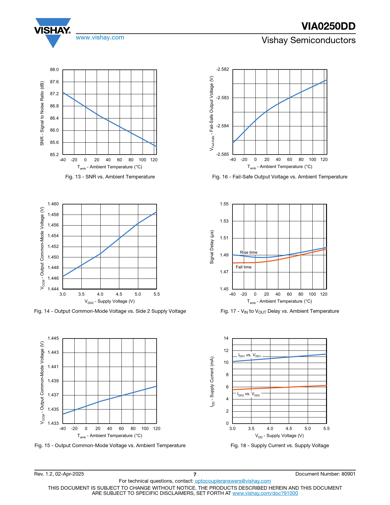

www.vishay.com Vishay Semiconductors Axis Title Axis Title 88.0 10000 -2.582 10000 ) 87.6 (V B) d ltage 87.2 o 1000 V -2.583 1000 Ratio ( ise 86.8 ne ne ne ine ne ine Output No 86.4 1st li 2nd li 1st li 2nd l l to afe 2nd li 2nd l a n -S 100 -2.584 100 86.0 Fail - Sig - fe 85.6 SNR il-Sa FaV 85.2 10 -2.585 10 -40 -20 0 20 40 60 80 100 120 -40 -20 0 20 40 60 80 100 120 T - Ambient Temperature (°C) T - Ambient Temperature (°C) amb amb Fig. 13 - SNR vs. Ambient Temperature Fig. 16 - Fail-Safe Output Voltage vs. Ambient Temperature Axis Title Axis Title 1.460 10000 1.55 10000 ) (V 1.458 ltage 1.53 o 1.456 V 1000 de s) 1000 o 1.454 (µ 1.51 y ne ne ne ine n-M ne ine o 1.452 m 1st li 2nd li l Dela Rise time 1st li 2nd l m 2nd l 2nd li a o 1.49 1.450 n C 100 100 Sig 1.448 Fall time 1.47 - Output 1.446 OCMV 1.444 10 1.45 10 3.0 3.5 4.0 4.5 5.0 5.5 -40 -20 0 20 40 60 80 100 120 V - Supply Voltage (V) T - Ambient Temperature (°C) DD2 amb Fig. 14 - Output Common-Mode Voltage vs. Side 2 Supply Voltage Fig. 17 - VIN to VOUT Delay vs. Ambient Temperature Axis Title Axis Title 1.445 10000 14 10000 ) (V 1.443 12 ltage ) I vs. V DD1 DD1 o A V 10 1.441 1000 (m de 1000 o rrent 8 ne ne u ne ne ine n-M ine o 1.439 m C 1st li y 2nd li 6 1st li 2nd l m 2nd li 2nd l o C 1.437 100 uppl I vs. V DD2 DD2 100 S 4 - I DD 1.435 - Output 2 OCMV 1.433 10 0 10 -40 -20 0 20 40 60 80 100 120 3.0 3.5 4.0 4.5 5.0 5.5 T - Ambient Temperature (°C) V - Supply Voltage (V) amb DD Fig. 15 - Output Common-Mode Voltage vs. Ambient Temperature Fig. 18 - Supply Current vs. Supply Voltage Rev. 1.2, 02-Apr-2025
