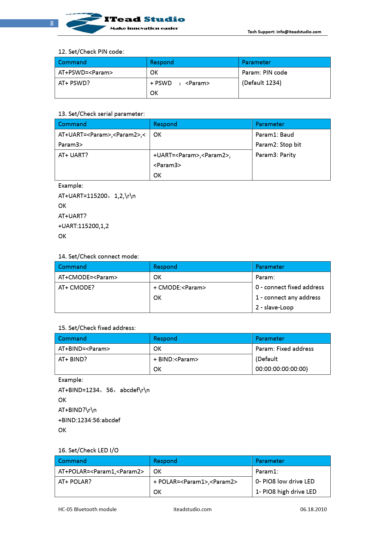

12. Set/Check PIN code: Command Respond Parameter AT+PSWD=<Param> OK Param: PIN code AT+ PSWD? + PSWD :<Param> (Default 1234) OK 13. Set/Check serial parameter: Command Respond Parameter AT+UART=<Param>,<Param2>,< OK Param1: Baud Param3> Param2: Stop bit AT+ UART? +UART=<Param>,<Param2>, Param3: Parity <Param3> OK Example: AT+UART=115200,1,2,\r\n OK AT+UART? +UART:115200,1,2 OK 14. Set/Check connect mode: Command Respond Parameter AT+CMODE=<Param> OK Param: AT+ CMODE? + CMODE:<Param> 0 - connect fixed address OK 1 - connect any address 2 - slave-Loop 15. Set/Check fixed address: Command Respond Parameter AT+BIND=<Param> OK Param: Fixed address AT+ BIND? + BIND:<Param> (Default OK 00:00:00:00:00:00) Example: AT+BIND=1234,56,abcdef\r\n OK AT+BIND?\r\n +BIND:1234:56:abcdef OK 16. Set/Check LED I/O Command Respond Parameter AT+POLAR=<Param1,<Param2> OK Param1: AT+ POLAR? + POLAR=<Param1>,<Param2> 0- PIO8 low drive LED OK 1- PIO8 high drive LED HC-05 Bluetooth module iteadstudio.com 06.18.2010
