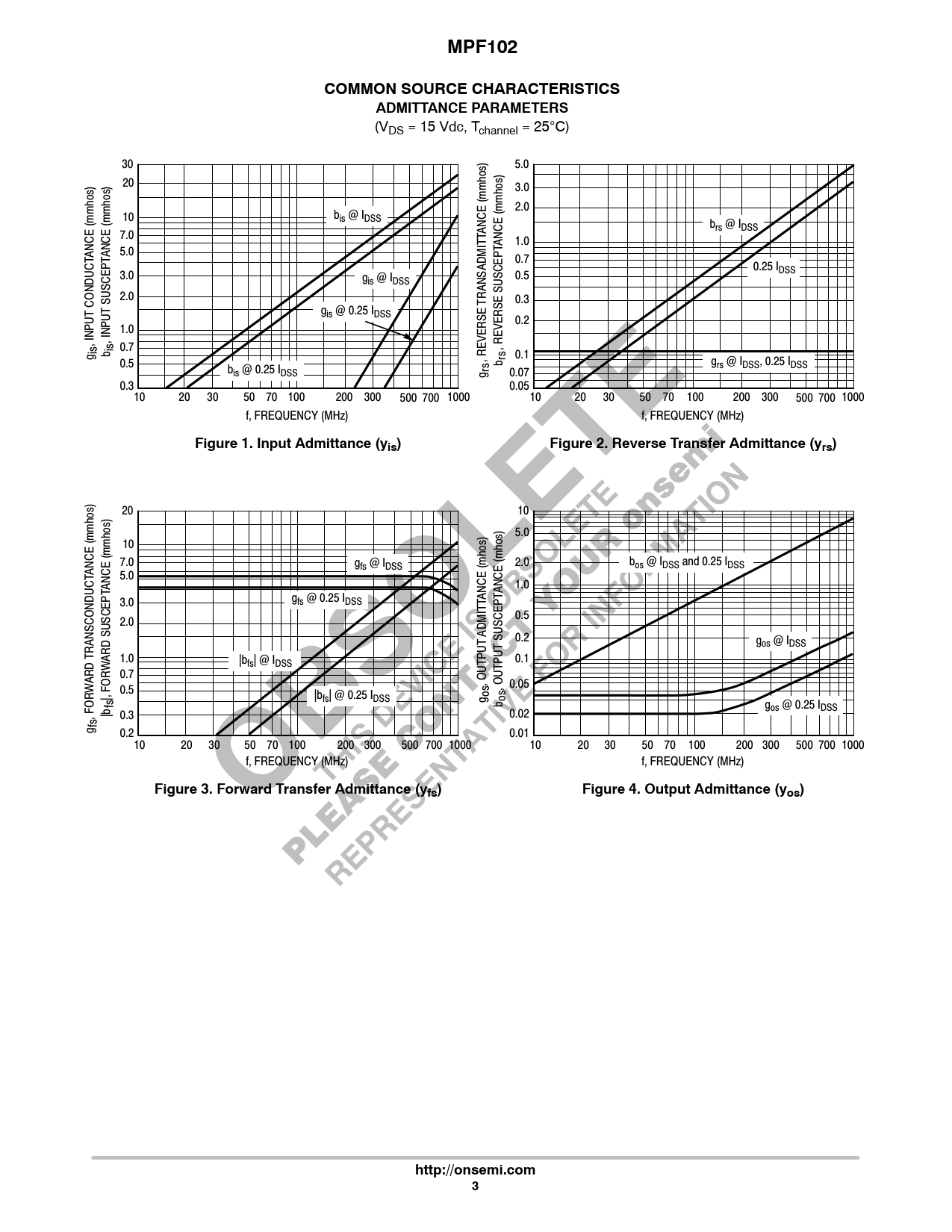

MPF102. COMMON SOURCE CHARACTERISTICS. ADMITTANCE PARAMETERS. Figure 1. Input Admittance (yis)
MPF102 COMMON SOURCE CHARACTERISTICS ADMITTANCE PARAMETERS Figure 1 Input Admittance (yis)
(VDS = 15 Vdc, Tchannel = 25C) 30 5.0 20 3.0 2.0 10 bis @ IDSS brs @ IDSS 7.0 ANCE (mmhos) ANCE (mmhos) 1.0 ANCE (mmhos) ANCE (mmhos) 5.0 0.7 0.25 I 3.0 DSS g 0.5 is @ IDSS 2.0 0.3 CONDUCT SUSCEPT TRANSADMITT gis @ 0.25 IDSS 0.2 1.0 , INPUT , INPUT is is 0.7 , REVERSE SUSCEPT g b rs 0.1 0.5 , REVERSE b g b rs rs @ IDSS, 0.25 IDSS is @ 0.25 IDSS g 0.07 0.3 0.05 10 20 30 50 70 100 200 300 500 700 1000 10 20 30 50 70 100 200 300 500 700 1000 f, FREQUENCY (MHz) f, FREQUENCY (MHz)
Figure 1. Input Admittance (yis) Figure 2. Reverse Transfer Admittance (yrs)
20 10 5.0 10 7.0 g 2.0 bos @ IDSS and 0.25 IDSS ANCE (mmhos) fs @ IDSS 5.0 ANCE (mmhos) ANCE (mhos) 1.0 ANCE (mhos) 3.0 gfs @ 0.25 IDSS 0.5 2.0 ADMITT SUSCEPT 0.2 gos @ IDSS TRANSCONDUCT ARD SUSCEPT 1.0 |b 0.1 W fs| @ IDSS ARD 0.7 , OUTPUT W 0.05 0.5 , OUTPUT |, FOR os |bfs| @ 0.25 IDSS os fs g b gos @ 0.25 IDSS , FOR |b 0.3 0.02 fsg 0.2 0.01 10 20 30 50 70 100 200 300 500 700 1000 10 20 30 50 70 100 200 300 500 700 1000 f, FREQUENCY (MHz) f, FREQUENCY (MHz)
Figure 3. Forward Transfer Admittance (yfs) Figure 4. Output Admittance (yos) http://onsemi.com 3
