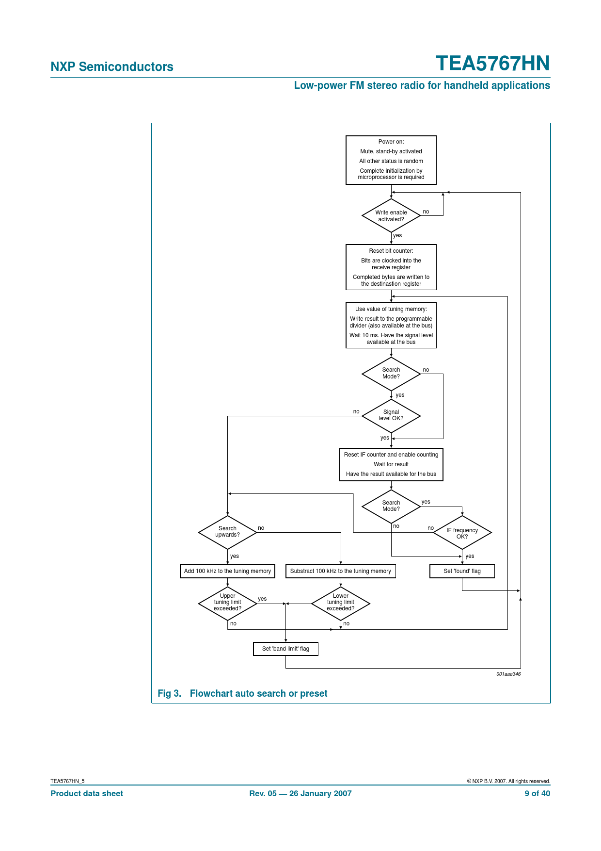

NXP Semiconductors. TEA5767HN. Low-power FM stereo radio for handheld applications. Fig 3. Flowchart auto search or preset
NXP Semiconductors TEA5767HN Low-power FM stereo radio for handheld applications Fig 3 Flowchart auto search or preset
Power on: Mute, stand-by activated All other status is random Complete initialization by microprocessor is required no Write enable activated? yes Reset bit counter: Bits are clocked into the receive register Completed bytes are written to the destinastion register Use value of tuning memory: Write result to the programmable divider (also available at the bus) Wait 10 ms. Have the signal level available at the bus Search no Mode? yes no Signal level OK? yes Reset IF counter and enable counting Wait for result Have the result available for the bus Search yes Mode? Search no no no IF frequency upwards? OK? yes yes Add 100 kHz to the tuning memory Substract 100 kHz to the tuning memory Set 'found' flag Upper Lower yes tuning limit tuning limit exceeded? exceeded? no no Set 'band limit' flag 001aae346
