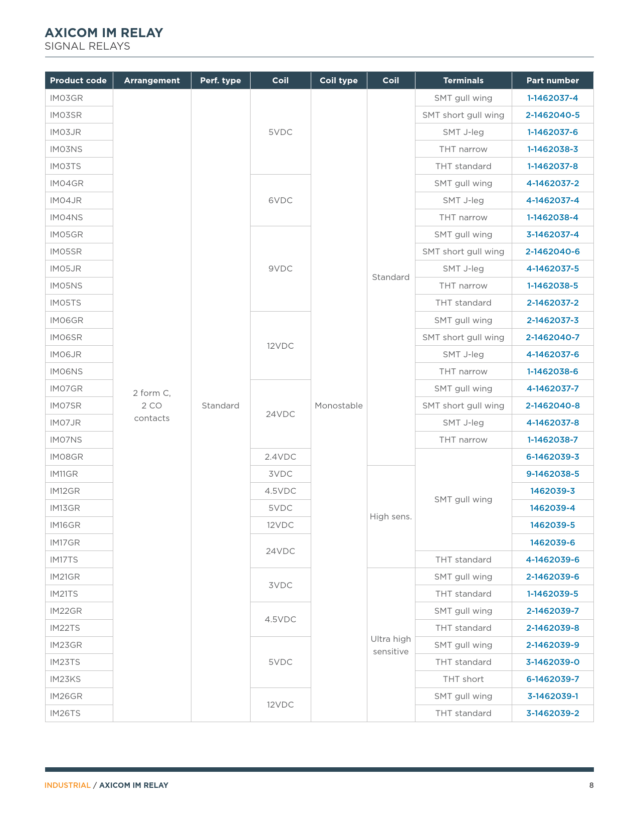

AXICOM IM RELAY. Product code. Arrangement. Perf. type. Coil. Coil type. Terminals. Part number
AXICOM IM RELAY Product code Arrangement Perf type Coil Coil type Terminals Part number
AXICOM IM RELAY
SIGNAL RELAYS
Product code Arrangement Perf. type Coil Coil type Coil Terminals Part number
IM03GR SMT gull wing 1-1462037-4 IM03SR SMT short gull wing 2-1462040-5 IM03JR 5VDC SMT J-leg 1-1462037-6 IM03NS THT narrow 1-1462038-3 IM03TS THT standard 1-1462037-8 IM04GR SMT gull wing 4-1462037-2 IM04JR 6VDC SMT J-leg 4-1462037-4 IM04NS THT narrow 1-1462038-4 IM05GR SMT gull wing 3-1462037-4 IM05SR SMT short gull wing 2-1462040-6 IM05JR 9VDC SMT J-leg 4-1462037-5 Standard IM05NS THT narrow 1-1462038-5 IM05TS THT standard 2-1462037-2 IM06GR SMT gull wing 2-1462037-3 IM06SR SMT short gull wing 2-1462040-7 12VDC IM06JR SMT J-leg 4-1462037-6 IM06NS THT narrow 1-1462038-6 IM07GR 2 form C, SMT gull wing 4-1462037-7 IM07SR 2 CO Standard Monostable SMT short gull wing 2-1462040-8 contacts 24VDC IM07JR SMT J-leg 4-1462037-8 IM07NS THT narrow 1-1462038-7 IM08GR 2.4VDC 6-1462039-3 IM11GR 3VDC 9-1462038-5 IM12GR 4.5VDC 1462039-3 SMT gull wing IM13GR 5VDC 1462039-4 High sens. IM16GR 12VDC 1462039-5 IM17GR 1462039-6 24VDC IM17TS THT standard 4-1462039-6 IM21GR SMT gull wing 2-1462039-6 3VDC IM21TS THT standard 1-1462039-5 IM22GR SMT gull wing 2-1462039-7 4.5VDC IM22TS THT standard 2-1462039-8 Ultra high IM23GR SMT gull wing 2-1462039-9 sensitive IM23TS 5VDC THT standard 3-1462039-0 IM23KS THT short 6-1462039-7 IM26GR SMT gull wing 3-1462039-1 12VDC IM26TS THT standard 3-1462039-2 INDUSTRIAL /
