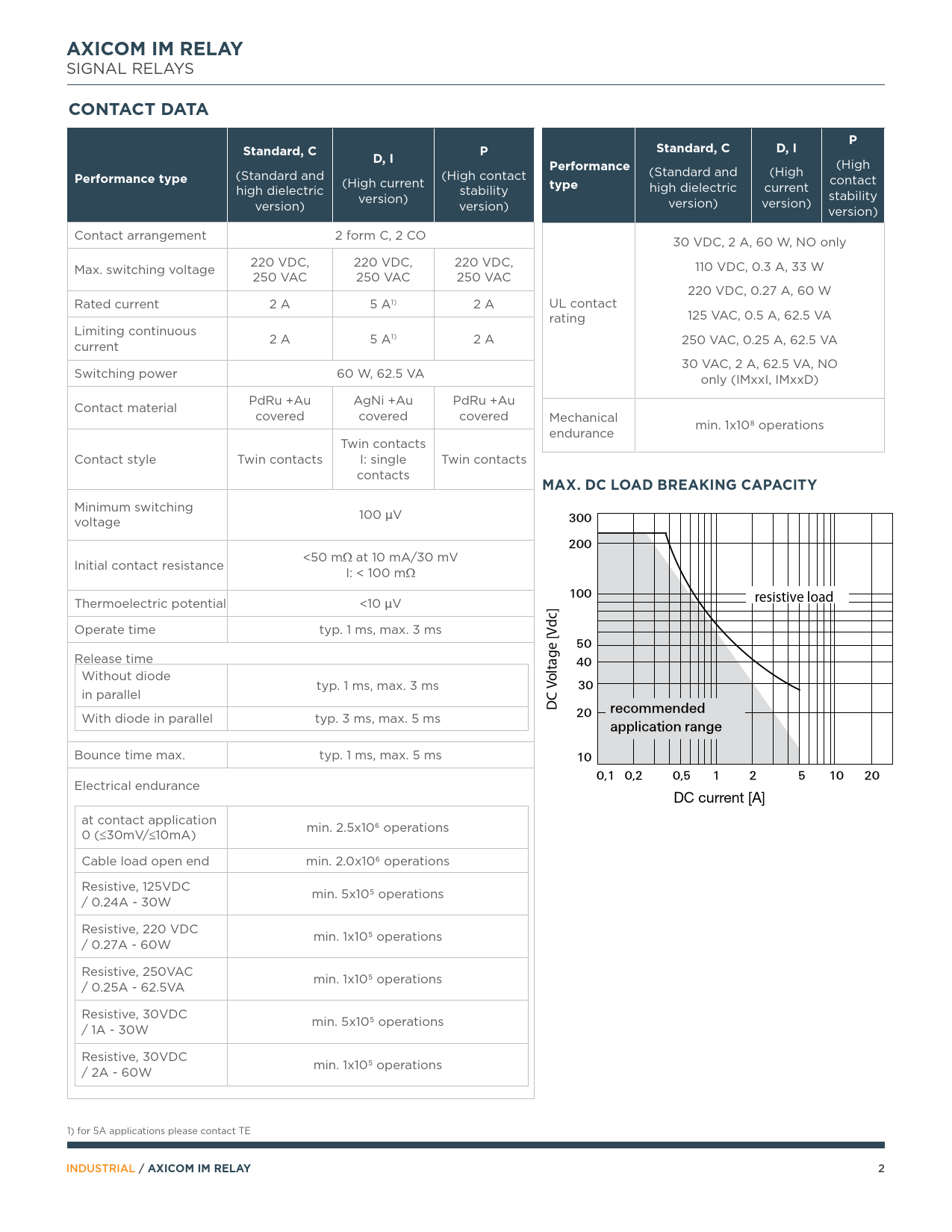

IM Relay. AXICOM IM RELAY. CONTACT DATA. Standard, C. D, I. Perf. ormance. Performance type. type. MAX. DC LOAD BREAKING CAPACITY

IM Relay
Contact Data IM-A IM-B IM-C IM-D IM-E Number of contacts and type 1ÊPoleÊbreak 1ÊPoleÊmake 1ÊPoleÊÊ 2ÊPoleÊbreak 2ÊPoleÊmake changeover Contact assembly BifurcatedÊcontacts Contact material Palladium-ruthenium,Êgold-covered Limiting continuous current 2ÊA 2ÊA 4ÊA 2ÊA 2ÊA at max. ambient temperature Maximum switching current 2ÊA 2ÊA 3ÊA 2ÊA 2ÊA Maximum swichting voltage 220ÊVdc

250ÊVac SIGNAL RELAYS Maximum switching capacity 60ÊW,Ê62.5ÊVA Thermoelectric potential <Ê10ʵV

Minimum switching voltage 100ʵV Initial contact resistance / < 100 mΩ < 100 mΩ NO < 100 mΩ < 50 mΩ < 50 mΩ

measuring condition: 10 mA / 20 mV

CC0 Contact category 0 (High
Performance type
(Standard and (High contact (Standard and (High (High current endurance (≤ 30 mV / ≥ 10 mA) contact high dielectric stability
type
min.Ê2.5ÊxÊ106Êoperations high dielectric current version) cable load open end stability version) version) min.Ê2.0ÊxÊ106Êoperations version) version) version) Contact arrangement 2 form C, 2 CO Resistive load at 125 Vdc / 0.24 A - 30 W min.Ê5ÊxÊ105Êoperations at 220 Vdc / 0.27 A - 60 30 VDC, 2 A, 60 WW , NO only min.Ê1ÊxÊ105Êoperations 220 VDC, 220 VDC, 220 VDC, at 250 Vac / 0.25 A - 62.5 Max. switching voltage min.Ê1ÊxÊ105Êoperations 110 VDC, 0.3 A, 33 W 250 VAC 250 VAC 250 VAC VA min.Ê5ÊxÊ105Êoperations at 30 Vdc / 1 A - 30 220 VDC, 0 W .27 A, 60 W min.Ê1ÊxÊ105Êoperations Rated current 2 A 5 A1) 2 A UL contact at 30 Vdc / 2 A - 60 W rating 125 VAC, 0.5 A, 62.5 VA Limiting continuous Mechanical endurance typ.Ê108Êoperations 2 A 5 A1) 2 A current UL contact ratings 250 VAC, 0.25 A, 62.5 VA 220 Vdc / 0.24 A - 60 W 125 Vdc / 0.24 A - 30 W 30 VAC, 2 A, 62.5 VA, NO Switching power 60 W, 62.5 VA 250 Vac / 0.25 A - 62.5 VA only (IMxxI, IMxxD) 125 Vac / 0.5 A - 62.5 VA PdRu +Au AgNi +Au PdRu +Au Contact material 30 Vdc / 2 A - 60 W covered covered covered Mechanical min. 1x108 operations endurance Twin contacts Contact style Twin contacts I: single Twin contacts Max. DC Load Breaking Capacity contacts
Minimum switching 100 voltage μV <50 mΩ at 10 mA/30 mV Initial contact resistance I: < 100 mΩ Thermoelectric potential <10 μV resistive load Operate time typ. 1 ms, max. 3 ms Release time Without diode oltage [Vdc] typ. 1 ms, max. 3 ms in parallel DC V With diode in parallel typ. 3 ms, max. 5 ms Bounce time max. typ. 1 ms, max. 5 ms Electrical endurance DC current [A] at contact application min. 2.5x106 operations 0 (≤30mV/≤10mA) Cable load open end min. 2.0x106 operations All specifications subject to change. Consult Tyco Electronics for latest specifications. 21 of 28 Resistive, 125VDC min. 5x105 operations / 0.24A - 30W Resistive, 220 VDC min. 1x105 operations / 0.27A - 60W Resistive, 250VAC min. 1x105 operations / 0.25A - 62.5VA Resistive, 30VDC min. 5x105 operations / 1A - 30W Resistive, 30VDC min. 1x105 operations / 2A - 60W 1) for 5A applications please contact TE INDUSTRIAL /
