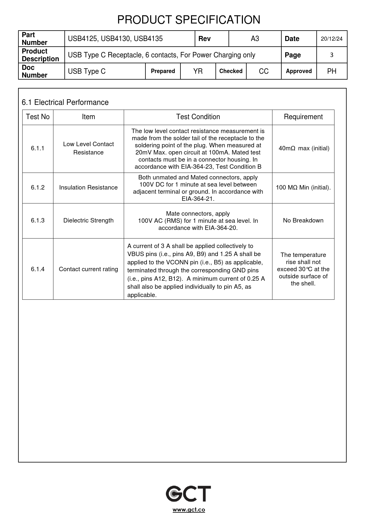

PRODUCT SPECIFICATION
Part
USB4125, USB4130, USB4135
Rev
A3
Date
20/12/24
Number Product
USB Type C Receptacle, 6 contacts, For Power Charging only
Page
3
Description Doc
USB Type C
Prepared
YR
Checked
CC
Approved
PH
Number
6.1 Electrical Performance Test No Item Test Condition Requirement The low level contact resistance measurement is made from the solder tail of the receptacle to the Low Level Contact soldering point of the plug. When measured at 6.1.1 40mΩ max (initial) Resistance 20mV Max. open circuit at 100mA. Mated test contacts must be in a connector housing. In accordance with EIA-364-23, Test Condition B Both unmated and Mated connectors, apply 100V DC for 1 minute at sea level between 6.1.2 Insulation Resistance 100 MΩ Min (initial). adjacent terminal or ground. In accordance with EIA-364-21. Mate connectors, apply 6.1.3 Dielectric Strength 100V AC (RMS) for 1 minute at sea level. In No Breakdown accordance with EIA-364-20. A current of 3 A shall be applied collectively to VBUS pins (i.e., pins A9, B9) and 1.25 A shall be The temperature applied to the VCONN pin (i.e., B5) as applicable, rise shall not 6.1.4 Contact current rating terminated through the corresponding GND pins exceed 30°C at the (i.e., pins A12, B12). A minimum current of 0.25 A outside surface of the shell. shall also be applied individually to pin A5, as applicable.
