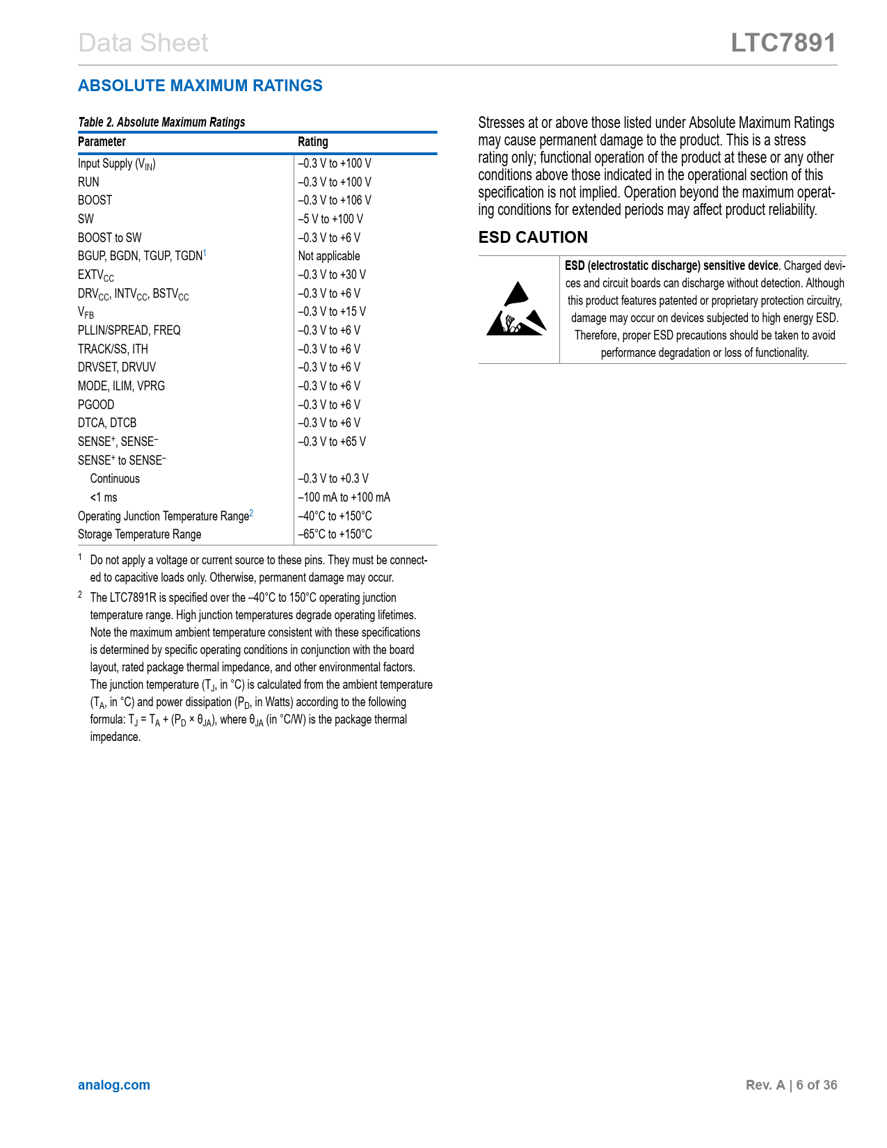

LTC7891. ABSOLUTE MAXIMUM RATINGS. Table 2. Absolute Maximum Ratings. Parameter. Rating. ESD CAUTION
LTC7891 ABSOLUTE MAXIMUM RATINGS Table 2 Absolute Maximum Ratings Parameter Rating ESD CAUTION
link to page 6 link to page 6 Data Sheet
LTC7891 ABSOLUTE MAXIMUM RATINGS Table 2. Absolute Maximum Ratings
Stresses at or above those listed under Absolute Maximum Ratings
Parameter Rating
may cause permanent damage to the product. This is a stress Input Supply (V rating only; functional operation of the product at these or any other IN) –0.3 V to +100 V RUN –0.3 V to +100 V conditions above those indicated in the operational section of this specification is not implied. Operation beyond the maximum operat- BOOST –0.3 V to +106 V ing conditions for extended periods may affect product reliability. SW –5 V to +100 V BOOST to SW –0.3 V to +6 V
ESD CAUTION
BGUP, BGDN, TGUP, TGDN1 Not applicable
ESD (electrostatic discharge) sensitive device
. Charged devi- EXTVCC –0.3 V to +30 V ces and circuit boards can discharge without detection. Although DRVCC, INTVCC, BSTVCC –0.3 V to +6 V this product features patented or proprietary protection circuitry, VFB –0.3 V to +15 V damage may occur on devices subjected to high energy ESD. PLLIN/SPREAD, FREQ –0.3 V to +6 V Therefore, proper ESD precautions should be taken to avoid TRACK/SS, ITH –0.3 V to +6 V performance degradation or loss of functionality. DRVSET, DRVUV –0.3 V to +6 V MODE, ILIM, VPRG –0.3 V to +6 V PGOOD –0.3 V to +6 V DTCA, DTCB –0.3 V to +6 V SENSE+, SENSE– –0.3 V to +65 V SENSE+ to SENSE– Continuous –0.3 V to +0.3 V <1 ms –100 mA to +100 mA Operating Junction Temperature Range2 –40°C to +150°C Storage Temperature Range –65°C to +150°C 1 Do not apply a voltage or current source to these pins. They must be connect- ed to capacitive loads only. Otherwise, permanent damage may occur. 2 The LTC7891R is specified over the –40°C to 150°C operating junction temperature range. High junction temperatures degrade operating lifetimes. Note the maximum ambient temperature consistent with these specifications is determined by specific operating conditions in conjunction with the board layout, rated package thermal impedance, and other environmental factors. The junction temperature (TJ, in °C) is calculated from the ambient temperature (TA, in °C) and power dissipation (PD, in Watts) according to the following formula: TJ = TA + (PD × θJA), where θJA (in °C/W) is the package thermal impedance.
