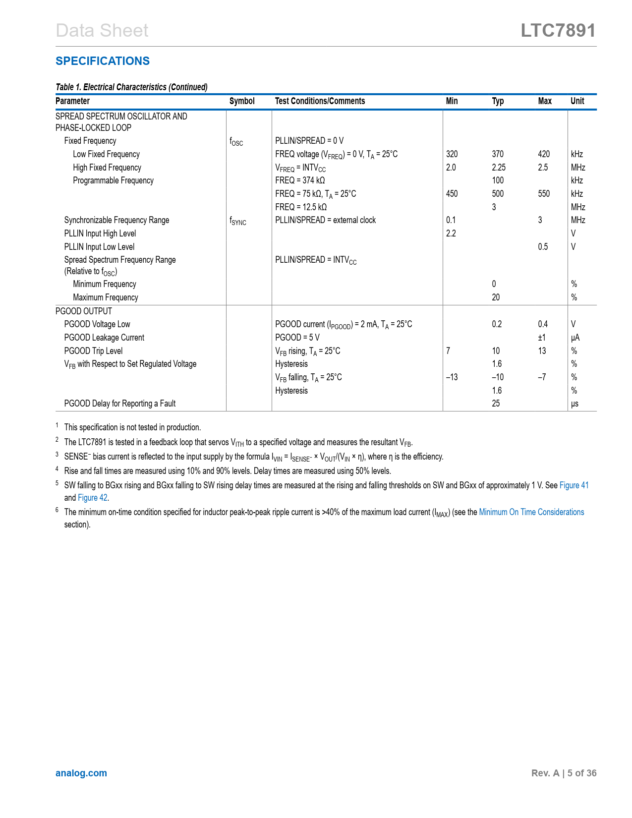

LTC7891. SPECIFICATIONS. Table 1. Electrical Characteristics (Continued). Parameter. Symbol. Test Conditions/Comments. Min. Typ. Max
LTC7891 SPECIFICATIONS Table 1 Electrical Characteristics (Continued) Parameter Symbol Test Conditions/Comments Min Typ Max
link to page 22 link to page 22 link to page 26 Data Sheet
LTC7891 SPECIFICATIONS Table 1. Electrical Characteristics (Continued) Parameter Symbol Test Conditions/Comments Min Typ Max Unit
SPREAD SPECTRUM OSCILLATOR AND PHASE-LOCKED LOOP Fixed Frequency fOSC PLLIN/SPREAD = 0 V Low Fixed Frequency FREQ voltage (VFREQ) = 0 V, TA = 25°C 320 370 420 kHz High Fixed Frequency VFREQ = INTVCC 2.0 2.25 2.5 MHz Programmable Frequency FREQ = 374 kΩ 100 kHz FREQ = 75 kΩ, TA = 25°C 450 500 550 kHz FREQ = 12.5 kΩ 3 MHz Synchronizable Frequency Range fSYNC PLLIN/SPREAD = external clock 0.1 3 MHz PLLIN Input High Level 2.2 V PLLIN Input Low Level 0.5 V Spread Spectrum Frequency Range PLLIN/SPREAD = INTVCC (Relative to fOSC) Minimum Frequency 0 % Maximum Frequency 20 % PGOOD OUTPUT PGOOD Voltage Low PGOOD current (IPGOOD) = 2 mA, TA = 25°C 0.2 0.4 V PGOOD Leakage Current PGOOD = 5 V ±1 µA PGOOD Trip Level VFB rising, TA = 25°C 7 10 13 % VFB with Respect to Set Regulated Voltage Hysteresis 1.6 % VFB falling, TA = 25°C –13 –10 –7 % Hysteresis 1.6 % PGOOD Delay for Reporting a Fault 25 µs 1 This specification is not tested in production. 2 The LTC7891 is tested in a feedback loop that servos VITH to a specified voltage and measures the resultant VFB. 3 SENSE− bias current is reflected to the input supply by the formula IVIN = ISENSE− × VOUT/(VIN × η), where η is the efficiency. 4 Rise and fall times are measured using 10% and 90% levels. Delay times are measured using 50% levels. 5 SW falling to BGxx rising and BGxx falling to SW rising delay times are measured at the rising and falling thresholds on SW and BGxx of approximately 1 V. See Figure 41 and Figure 42. 6 The minimum on-time condition specified for inductor peak-to-peak ripple current is >40% of the maximum load current (IMAX) (see the Minimum On Time Considerations section).
