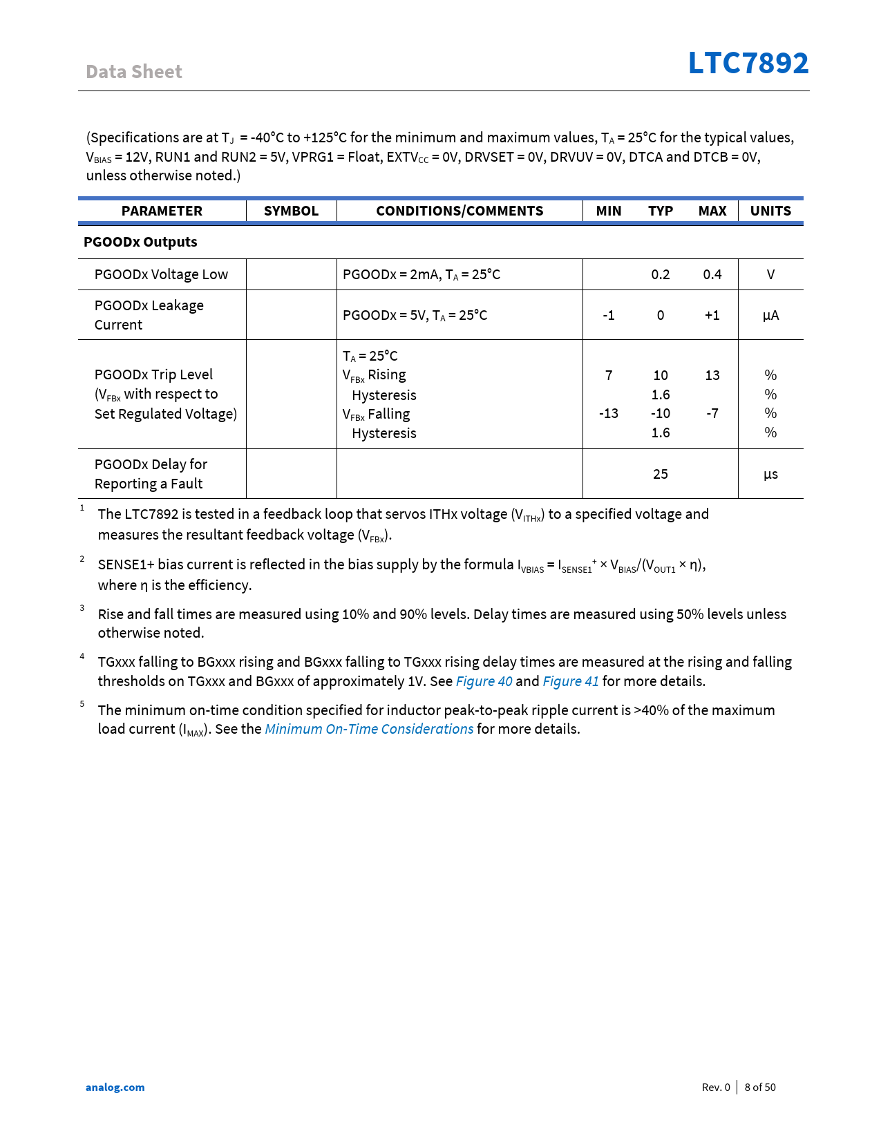

(Specifications are at TJ = -40°C to +125°C for the minimum and maximum values, TA = 25°C for the typical values, VBIAS = 12V, RUN1 and RUN2 = 5V, VPRG1 = Float, EXTVCC = 0V, DRVSET = 0V, DRVUV = 0V, DTCA and DTCB = 0V, unless otherwise noted.)
PARAMETER SYMBOL CONDITIONS/COMMENTS MIN TYP MAX UNITS PGOODx Outputs
PGOODx Voltage Low PGOODx = 2mA, TA = 25°C 0.2 0.4 V PGOODx Leakage PGOODx = 5V, T Current A = 25°C -1 0 +1 µA TA = 25°C PGOODx Trip Level VFBx Rising 7 10 13 % (VFBx with respect to Hysteresis 1.6 % Set Regulated Voltage) VFBx Falling -13 -10 -7 % Hysteresis 1.6 % PGOODx Delay for 25 µs Reporting a Fault .1 The LTC7892 is tested in a feedback loop that servos ITHx voltage (VITHx) to a specified voltage and measures the resultant feedback voltage (VFBx). 2 SENSE1+ bias current is reflected in the bias supply by the formula I + VBIAS = ISENSE1 × VBIAS/(VOUT1 × η), where η is the efficiency. 3 Rise and fall times are measured using 10% and 90% levels. Delay times are measured using 50% levels unless otherwise noted. 4 TGxxx falling to BGxxx rising and BGxxx falling to TGxxx rising delay times are measured at the rising and falling thresholds on TGxxx and BGxxx of approximately 1V. See Figure 40 and Figure 41 for more details. 5 The minimum on-time condition specified for inductor peak-to-peak ripple current is >40% of the maximum load current (IMAX). See the Minimum On-Time Considerations for more details.
