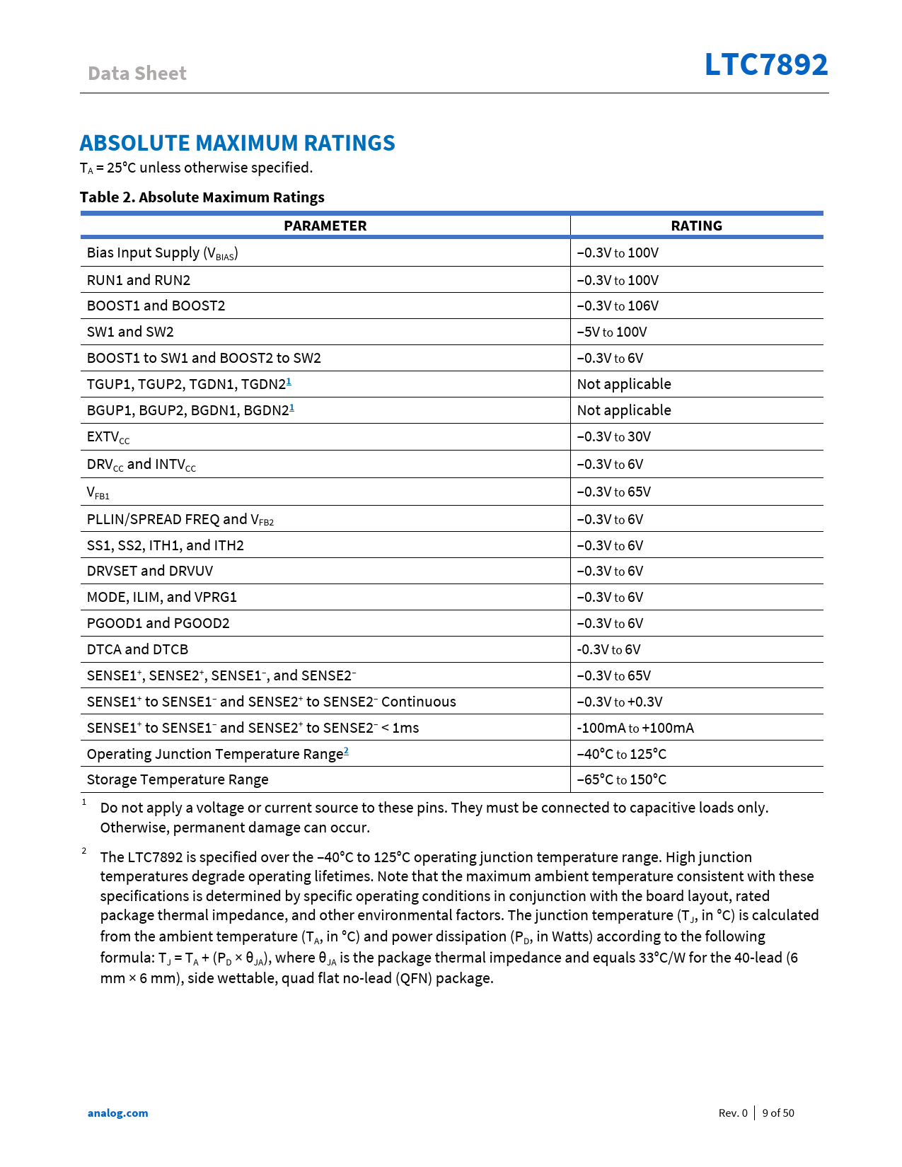

Data Sheet LTC7892 ABSOLUTE MAXIMUM RATINGS
TA = 25°C unless otherwise specified.
Table 2. Absolute Maximum Ratings PARAMETER RATING
Bias Input Supply (VBIAS) –0.3V to 100V RUN1 and RUN2 –0.3V to 100V BOOST1 and BOOST2 –0.3V to 106V SW1 and SW2 –5V to 100V BOOST1 to SW1 and BOOST2 to SW2 –0.3V to 6V TGUP1, TGUP2, TGDN1, TGDN2
1
Not applicable BGUP1, BGUP2, BGDN1, BGDN2
1
Not applicable EXTVCC –0.3V to 30V DRVCC and INTVCC –0.3V to 6V VFB1 –0.3V to 65V PLLIN/SPREAD FREQ and VFB2 –0.3V to 6V SS1, SS2, ITH1, and ITH2 –0.3V to 6V DRVSET and DRVUV –0.3V to 6V MODE, ILIM, and VPRG1 –0.3V to 6V PGOOD1 and PGOOD2 –0.3V to 6V DTCA and DTCB -0.3V to 6V SENSE1+, SENSE2+, SENSE1–, and SENSE2– –0.3V to 65V SENSE1+ to SENSE1– and SENSE2+ to SENSE2– Continuous –0.3V to +0.3V SENSE1+ to SENSE1– and SENSE2+ to SENSE2– < 1ms -100mA to +100mA Operating Junction Temperature Range
2
–40°C to 125°C Storage Temperature Range –65°C to 150°C .1 Do not apply a voltage or current source to these pins. They must be connected to capacitive loads only. Otherwise, permanent damage can occur. 2 The LTC7892 is specified over the –40°C to 125°C operating junction temperature range. High junction temperatures degrade operating lifetimes. Note that the maximum ambient temperature consistent with these specifications is determined by specific operating conditions in conjunction with the board layout, rated package thermal impedance, and other environmental factors. The junction temperature (TJ, in °C) is calculated from the ambient temperature (TA, in °C) and power dissipation (PD, in Watts) according to the following formula: TJ = TA + (PD × θJA), where θJA is the package thermal impedance and equals 33°C/W for the 40-lead (6 mm × 6 mm), side wettable, quad flat no-lead (QFN) package.
